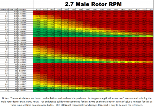

Redeye/ Demon blower rpm 2,7 from SDG

Excellent! For what its worth I have been running a 10 % ATI and the stock upper pulley, with 6500 shift points . As you can see from this chart this is the reason I chose to go to with the bigger supercharger from the get go .

While my sc is getting modded I think I'm pulling the trigger on the 3.1 clutched upper to go with my 10% lower that should do the trick with upgraded pumps and injectors.
14,805
45,511
4,870
11,001
What will be your max rpm ?

6600.or till it blows whichever comes first.
