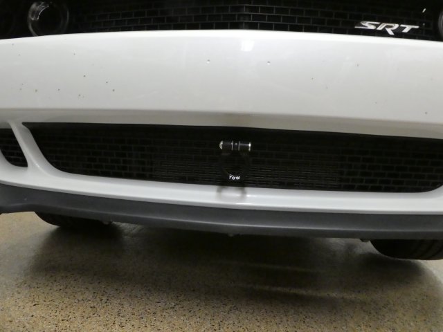

I have ZL1s. Can do the front without removing the fascia (just the lower grill insert) if you are patient, careful, and have a very short right angle drill and bit. Some say it's easier to pop the facia off, but I decided to try it first without doing that - was successful and looks great - cannot even notice the receptacle at quick glance - only had to trim one of the small vertical slats to provide clearance for the hook.

That's why I tried it first without removing anything - I could locate fairly precisely where to put the mount with Sharpie marks without having a big hole in the grill insert - tradeoff for that vs. ease of drilling the mount holes by popping the fascia off.

Thanks! I'll see if I can borrow and angle drill. Front is definitely preferred.
