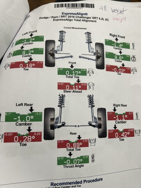

So at the big end of the track my car will head a little to the right. The mechanic states the alignment is fine for a daily driver. But when simulated with down force the alignment changes. Does that make sense? So he wanted to know if I wanted it aligned as a daily driver or for the quarter? If for the quarter the specs would be out of alignment for a daily driver.

The “road” alignment is to account for crown in the road that is there for water runoff. “Track” is for a flat surface. Split the difference and see if it changes enough to tell on either. The biggest factor for stability in a straight line is going to be toe. It needs to be “in” and critical that they are very close to the same on both fronts. Any toe out on one side or the other will steer the car in that direction. Of coarse the guy should know all that. The only change in alignment numbers that should change with downforce would be camber. That shouldn’t matter in a straight line. If he thinks that could be an issue then I would consider getting a second opinion. You’re talking a real alignment rack being used. Right? Also…. Frontrunners are super straight line stable. I’ve gone over 185 on mine and that’s about a hundred mph faster than 145. 😂 IMG_5470.jpeg

Spoke to Zach at AAD. He said the front AAD arms do not influence toe. Factory parts do. He actually is in Phoenix and has a shop. I am going to make an appointment with him and drive the car to his shop.

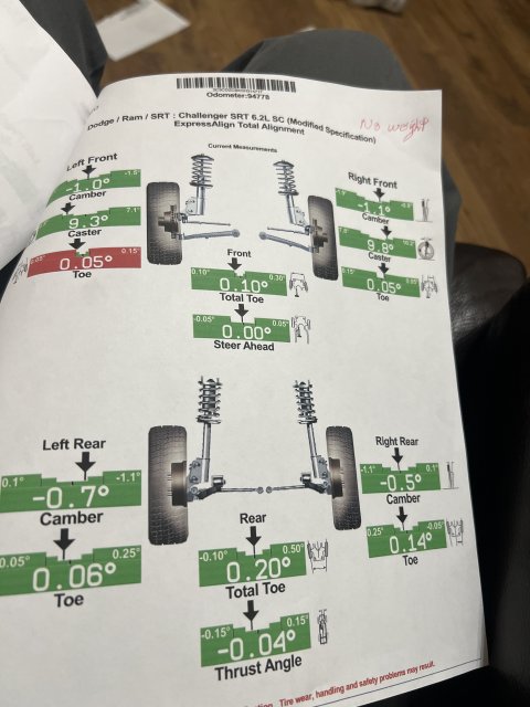

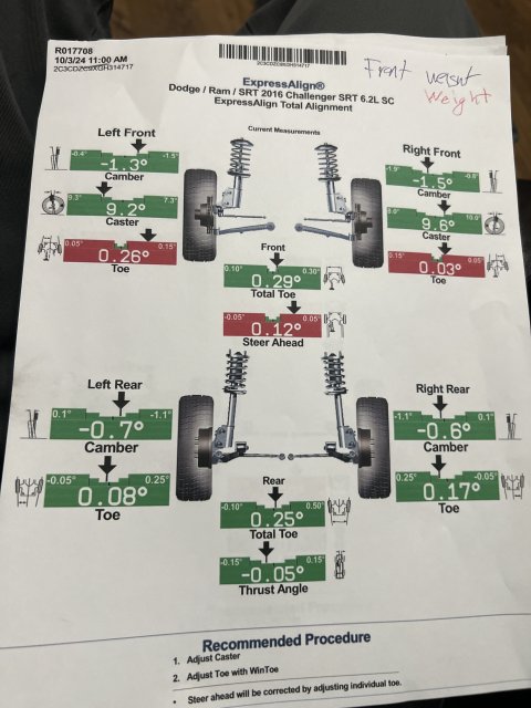

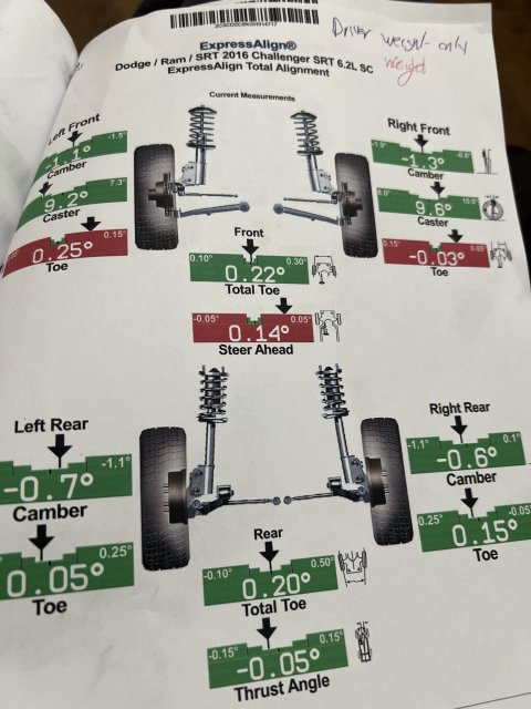

He did four readings. No weight, weight on entire car, weight on front, and weight in drivers seat.

Say what now? I want to learn don’t get me wrong. Which one is simply the car on the floor? If that is the all weight that rear toe needs to get adjusted big time. Then what is front weight? Why does the front toe move around? One side much more. What do you have for a suspension? Interesting diagrams something is up.

So the one with .05 on the left toe is no weight. One red block. I do not know what they mean by front weight. .26 on drivers side. All weight is .19 on toe on drivers side. .25 is driver in car. .25 toe on drivers side. In front upper aad arms and the rest is stick. In the rear a lot of bmr stuff and a cradle lockout.

Would this mean that something is loose? But I would think they would see that.

I notice with the reading with driver in the car the left toe has a positive reading of .26. That is not good! Possible tie rod being bad or needs adjustment. That causes instability.
