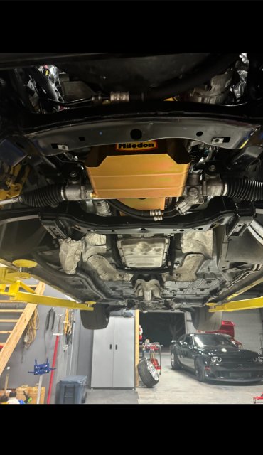

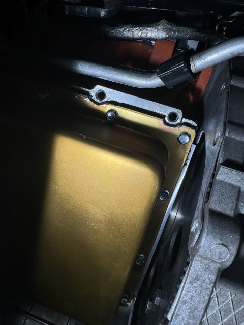

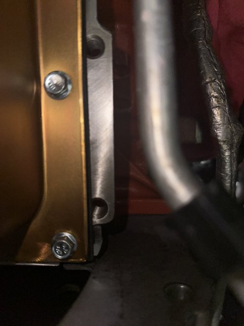

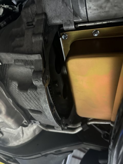

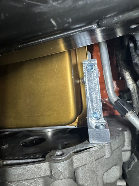

They will fit the pan will just need to be trimmed, all the aftermarket/sheet metal pans have to be clearanced to use them. I believe it is only about an 1/8th of an inch. i have attached some pictures of there the pan needs to have some material removed.

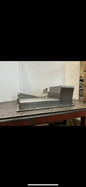

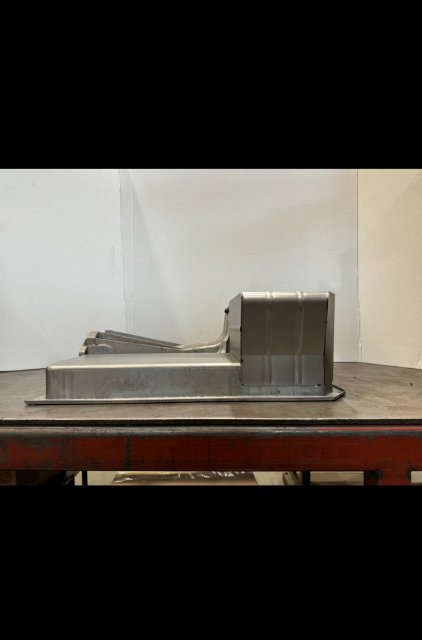

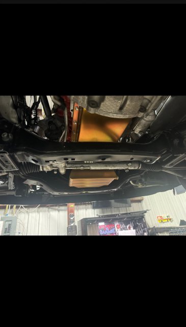

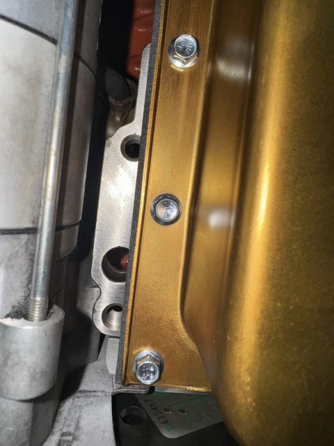

Here is where the pan was trimmed so the rear supports could be used. Milodon will be making an adjustment to their tooling so the future pans are already notched to use the braces. IMG_5632.jpeg IMG_5633.jpeg
