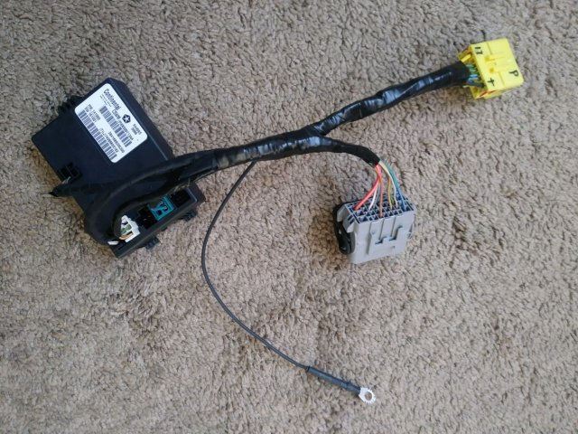

I make a setup to bypass the airbag/seatbelt light and re enable the Heated & Vented Seats. I do not sell many because it's really expensive. If you run that way a lot it might be worth it. 0613201838a.jpg
