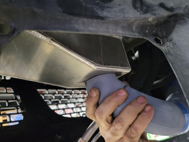

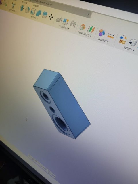

Thread Starter #20
Here is some more updates from Peitz Performance. Making it where a factory chiller on a Redeye will still function Resized_20231102_183340.jpeg Resized_20231102_183346.jpeg Resized_20231102_183356.jpeg Resized_20231102_183408.jpeg Resized_20231101_181643.jpeg Resized_20231101_181855.jpeg Resized_20231101_181848.jpeg
