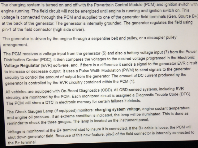

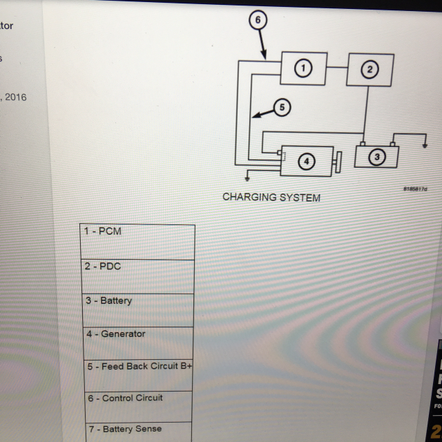

I found this which helps e plain some things but not enough for me, other than I hope I don’t need a new PCM.
