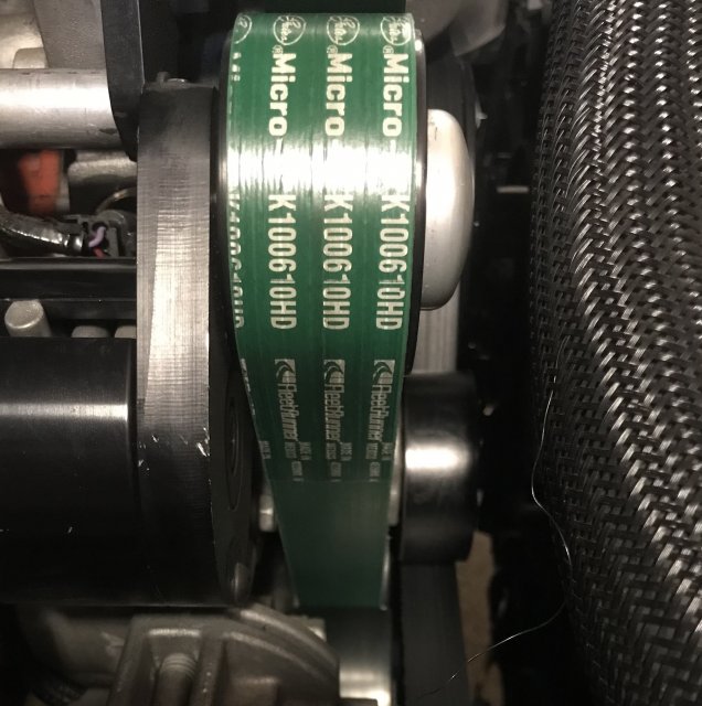

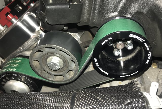

Yes they do 😂. Not exactly what you’re asking for but maybe something for your files. 2.75 Griptec with +10 ATI. No slip at 25 lbs. 47AF3F09-80E8-4384-A3CC-735301FCB7F3.jpeg 72E85E95-DC20-4695-B5EF-E49B4F755105.jpeg
