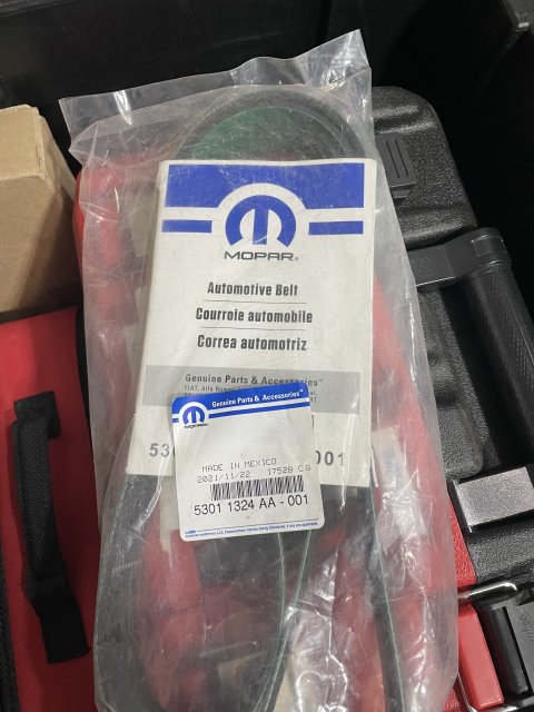

Having a little trouble locating the PN for the green belt.

I went black 😉 after you recommended it last year. I was looking through my stuff after the move and I can not find the OEM green belt so I wanted a backup. Thx

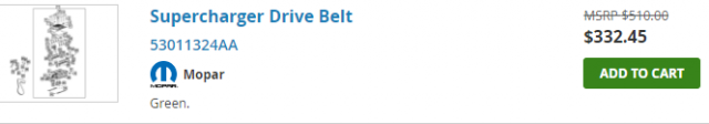

I think to get a new Green belt it is like $333

I believe my dealer passed on a cost of like $130. I know it was not $300 or I would not be holding that spare. P, if you have problems let me know. We need to take the Jeep to them for some attention and would help you if needed.

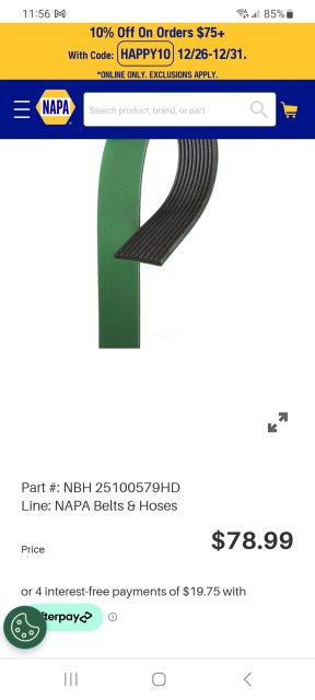

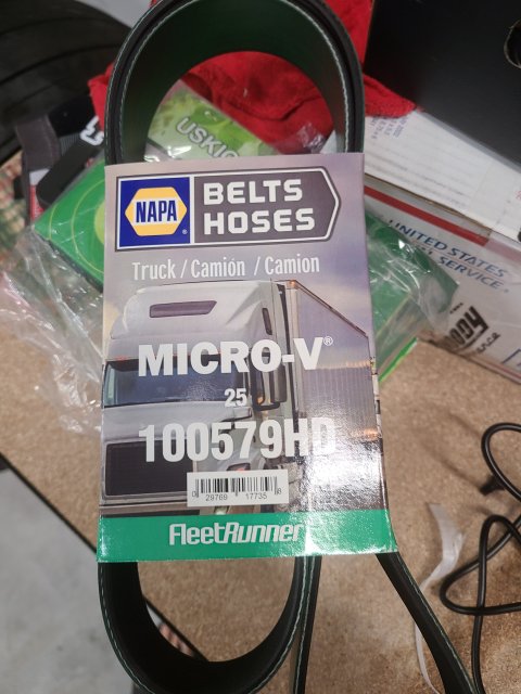

This should be the part number for the green belt if needed. It's made by Gates and this is sold at NAPA.

Verify the fit.

Gates K100579HD is only $38 on amazon... or you could pay double from Napa, or 10x from the (d|st)ealer.

$32.79 on rockauto, plus shipping ($10 for my zipcode) totals $43 for me--thus with $0 prime shipping it's cheaper from amazon for me--YMMV.
