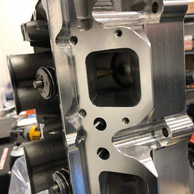

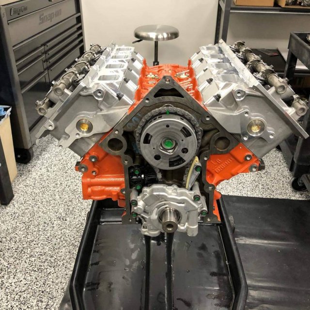

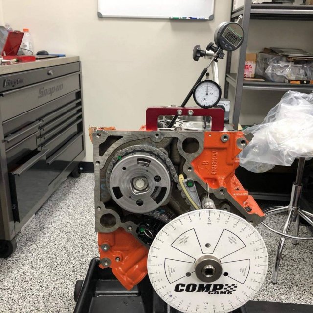

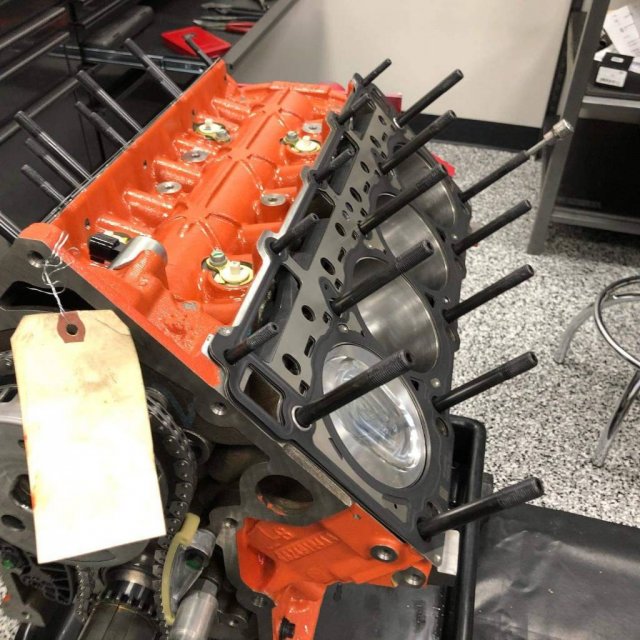

Let the build begin! 156349040_806608353286844_6723068599655346533_n.jpg 156646568_806608209953525_1015824828251653900_n.jpg 155577040_806608236620189_3508474850810944859_n.jpg 157608039_806608279953518_1044624665400862799_n.jpg 155448133_806608319953514_5171758570927819736_n.jpg

That is freaking pretty. Fun times up ahead.

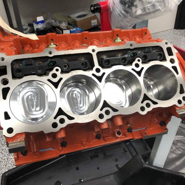

Interesting piston crowns.

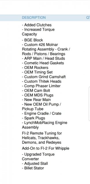

Is that for obtaining correct compression with quench, & swirl, nice build. That shop is immaculate the way it should be for engine build.

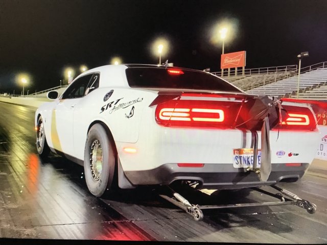

Low 9s hopefully but who really knows until it goes down the track
