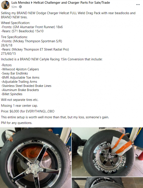

There is a guy on Facebook selling the exact setup i want with carlyles package but wants wire transfer or cash in person. Wont do paypal(n) Way too far to drive but could be a solid deal for someone down in Texas. That is if it's a real ad vs. all the scams. Guess i'll fork out a little bit more for factory direct new. Might be worth doing a 426 first but wouldn't be able to go fast in the car on 20's :unsure:

I saw that. Good deal for somebody local that could pick up, but that’s a lot of money to risk for the savings. I know that some don’t like PayPal (I don’t particularly care for them either) but I have it and use it because it makes things work. That’s a lot to ship too. A lot to go wrong to save a little money. I wouldn’t do it either.
