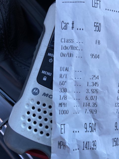

In case somebody wants to see the timeslip here it is. See how this year lays out for me but I will definitely be shooting for a 9.4x's as soon as I have the opportunity but good DA is hard to come by in SouthTexas. Sorry for the long post. I promise I don't normally do this. Look forward to sharing with everyone here.
