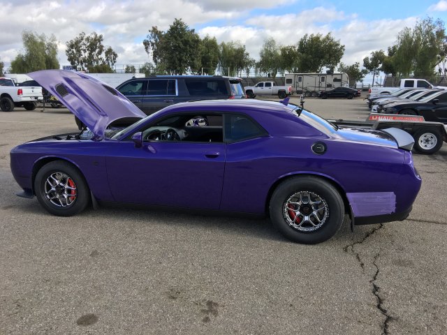

Hi all,
I need a new Trans for my 2016 Hellcat Challenger with all the common mods and tune for 950hp. Most mod work done at under 4,000 miles by reputable shop. Then upgraded to FF, dual pumps, etc. with one of the very top tuners. New SC and Engine and pcm/tcm tunes at 12k again top shop and tuner. Now she needs new a trans. after approx. 100 >9.9 1/4mi. passes and street driving, hot rodding around since normal 500mi. break in.
So, Here I am needing a new “Reliable” trans. I’ve narrowed it down to these options but just can’t decide. Reliability for 3 or 4 test n tune type events a year and otherwise street driving is my main concern, not best et. I would really appreciate some of the Forums hard earned advice. 🙏🏻
