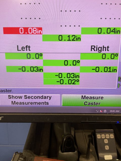

I had a 3:90 shipped to me on accident when I bought my billet diff. Switched to 3:09 no change in et or mph.
When my car was more stock went down the track every pass This is my rear alignment pulling down the rear end like it’s leaving the line. Trans in sport Susp in street. Held traction button in to turn that all off.
