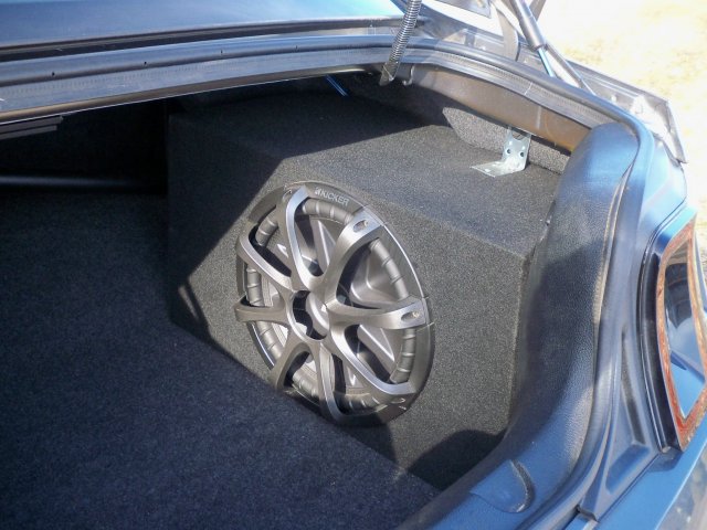

I found a box made to fit my last Mustang and put in a 10" Kicker. So there may be more options
