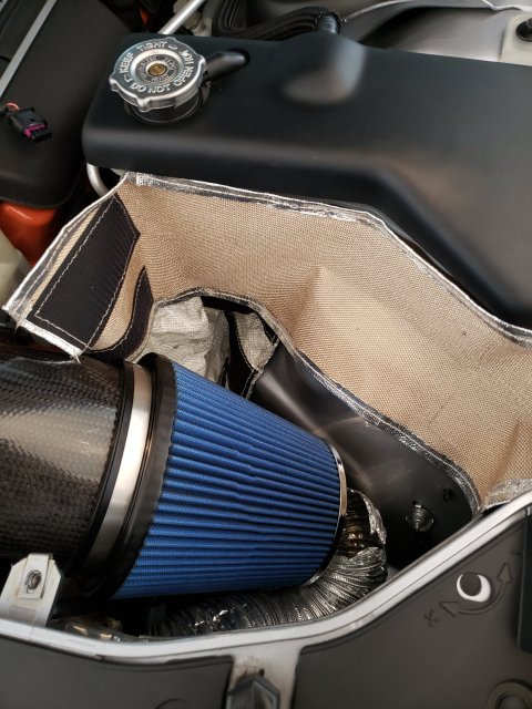

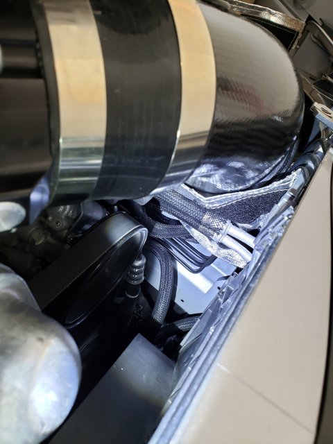

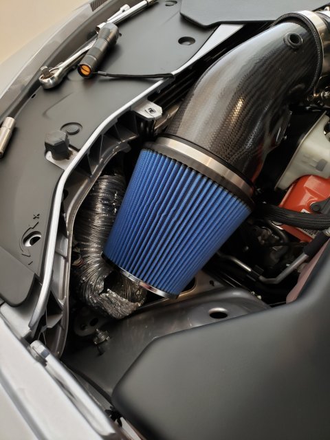

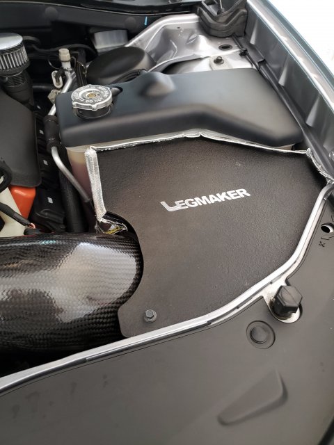

I got mine installed and played around with the 2 heat shields I have. One shields goes under the intake to the coolant tank. The other is blocking the coolant tank. My thoughts are getting some ceramic fiber insulation board to block off coolant tank and the area between the tank and filter. I will also use the heat shields
My tube I run to the airbox (stock charger is really small) was long enough to bend in front of the filter

went out and drove the car. Temp gun towards the back on the outside of heatshield was reading 140 degrees. Pointing it into the air box it was showing 85. When the fan kicked on it just heated everything up. It will need to be sealed towards the front and between the intake and lid
If the fan spun the other way it would help meaning the blades would have to go the other way to push the air towards the passenger side. I don't notice as much heat being blown towards the passenger side. In testing I'm surprised the engineers did pick up on that. Having a shield to block the hot air blowing on the intake would be another fix

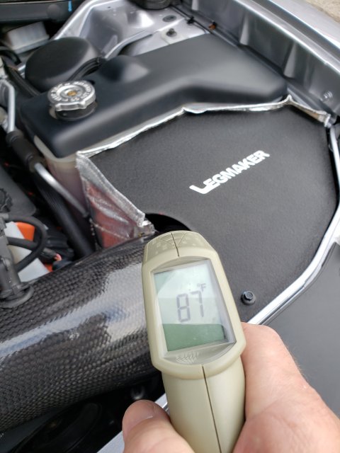

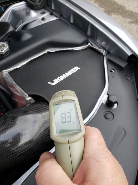

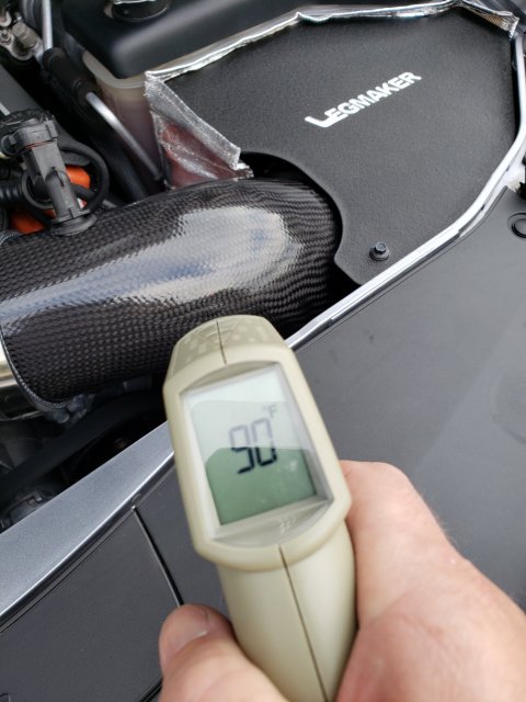

Drove to GR last night and popped the hood after 30 minutes of highway and street driving and took some readings.
3rd pic shows 87 and the dot appears to be on the lid. It was showing around 85 inside the box but moved when I took the pic. All the reading I got inside the box were in the 80's

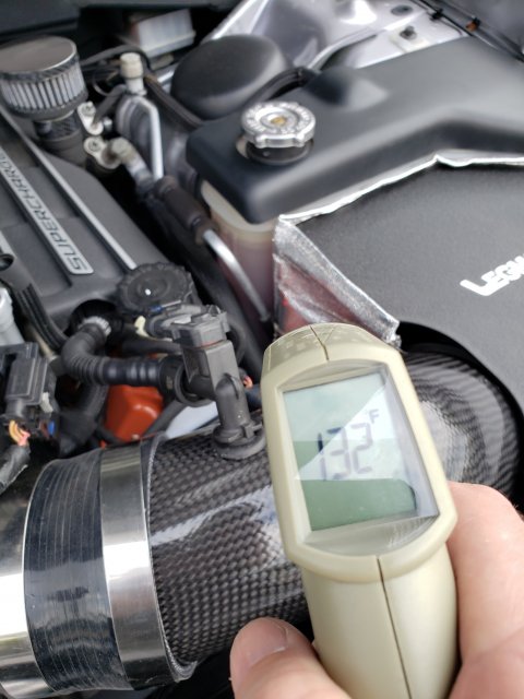

Haven't studied the stock air box for temps. Since putting the LMI on I have been watching them. Cooler day today. Temps were reading 66 and the IAT started at 77 leaving work. I noticed the IAT will be higher even after the car has sat all night Not much stopping on the way home but I do notice it will raise, I'm sure the stock one does also. Was low 80's when I got home. I hit some area's with my temp gun. The lid was 73, inside the box was in the 70's. The heat shield by the engine was 114-130. The intake tube was in the 80's
I don't think I could be able to get it cooler then what I'm seeing. At the track the shield should keep most of the hot air off of filter
When I was driving around yesterday, it was mid 80's and I had the air off which means the fan is on. Temps were over 100. I do remember looking at the temps with the stock air box and noticed 20 warmer then the outside air
