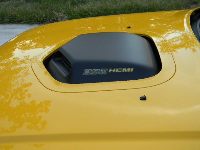

When I put the shaker on my Yellow Jacket. I did the the shaker in a satin, and cleared it with a satin clear coat, to avoid all that aggravation. It turned out perfect. 010.JPG

Looks good !!!
The shaker always looks bad ass

I would add that I was the the first to put the shaker package on the 392. I did it before Dodge did.

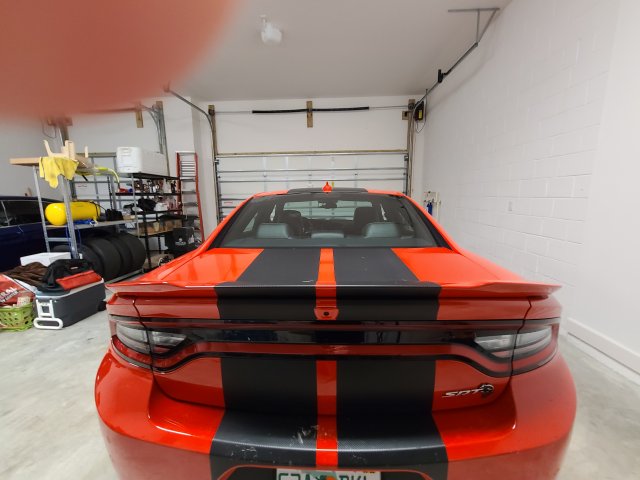

I have my guy clay bar mine and keep them coated in Reload. After 3 years they still looking good.

You can clay bar the stripes ?...interesting, I would of thought the clay would stick in the rough stripes, have not tried it.

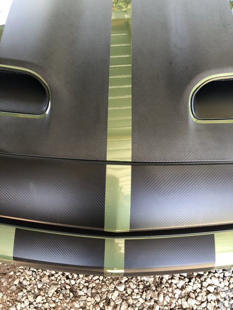

I would be wary of clay bar on the stripes and definitely NO WAX !! Remember, these are textured vinyl (3M 1080 series wrap material).
Mine were a mess on day 1 and I almost yanked them off. I have found that if you clean them following 3M's recommendations, then apply 303 protectant they come out looking 'even' with no blotches & are good for at least a few washes.
Apply the 303 sparingly to a MF covered sponge (helps get even coating into the nooks & crannies) and gently work it into the stripes. After doing the whole car, take a clean MF sponge and gently wipe in 1 direction to eliminate any streaks or excess 303. Store both sponges in a ziplock baggie, they will remain moist and can be used without adding more 303 for quickie touch-up as needed.
And as mentioned above, be careful on the bumpers as they are a 2 piece application with overlap (not end butted) and tend to start lifting on the corners if rubbed too hard !!

Just had my guy do them again. They were full of wax when I first got the car, dealer detail guy must of smeared wax all over them. Clay bar was the only thing that would clean them up. I them sprayed Reload on them and they've looked great since.

Still looking good and the car is filthy here.
