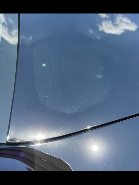

Here’s that messy area on the trunk. Obviously it looks worse in direct sunlight.

By highlighting, I was referring to the closeup picture you took of the burn.
If it is truly a clearcoat burn, my understanding is that the only correct way to deal with that is to refinish it.
(You obviously can't put the clear back on with more polishing...)

It’s from the assembly line. When they are inspecting the paint and find small imperfections such as dust or paint nibs they buff them out with a small handheld orbital buffer. Those small areas are not polished correctly after and leave cloudy areas where it was buffed. Def not burned through the clear. If you watch videos you can see workers with small handheld orbital buffer going around touching up the paint. That is what this is. For some reason it is really visible on the black paint. I had two pitch black challengers that both had this but luckily for me there was no paint protection over the clear so I was able to just hand polish the areas by hand and they came right out perfectly. Took me a long time to figure it out, dealers were no help. They actually wanted to repaint the car lol. Luckily for me a Brampton worker on the forum chimed in and posted what it was. In this case OP needs to get the paint protection off so he can polish those areas. How to remove that is the question. I would prob call the dealer and ask them what type of protection they apply and then use that information with a detailer.

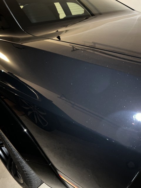

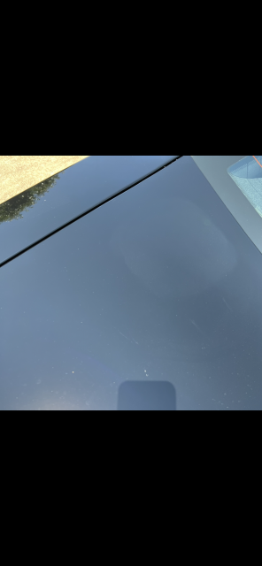

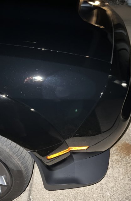

Few more pics. That area on the trunk looks a lot better obviously at a different angle and lighting. And the flash from the camera will make it look worse too.

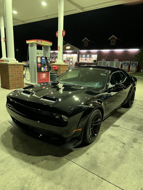

I Added a nice pic of my new HC too. I love the car so far. It’s awesome. The paint issues are minor and because it’s black , everything is gonna show up on it.
