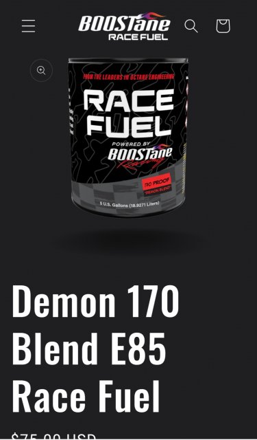

So they got it wrong if it's E85 :LOL:
Ask your buddy Demonology. It looks like they're sponsoring him.
I've always been curious about the 170 moniker? Why?

Sounds good? Better than Demon 130?
E85 is 170 proof. Tim K said it himself.

E85 is 170 proof but E85 maxes out the fuel system. Car makes full power on E65 which is 130 proof. I must be missing your point.
If Boostane wanted to make a Demon specific fuel E70 would have been more appropriate.

It’s just a gimmick
