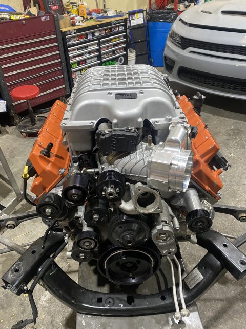

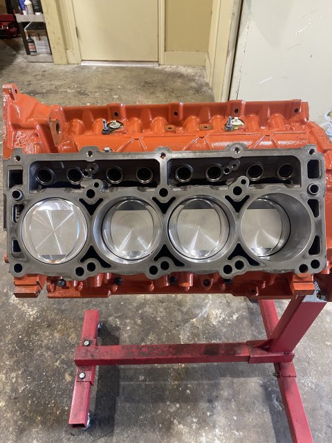

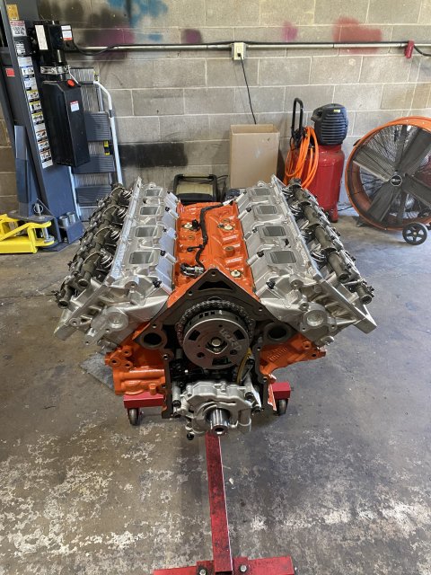

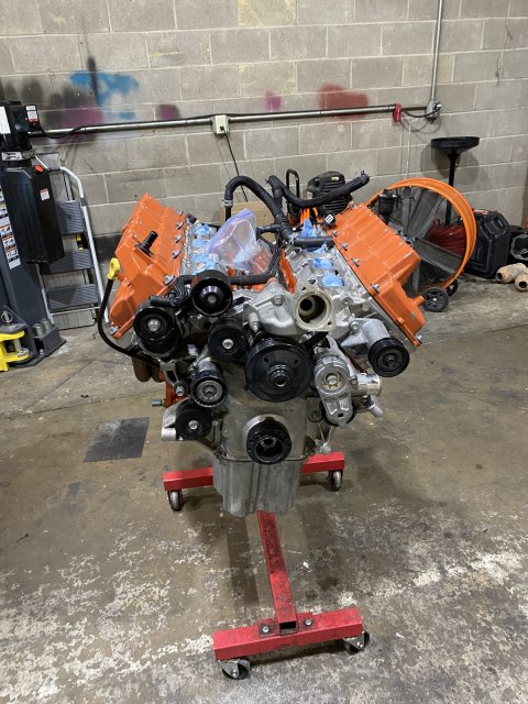

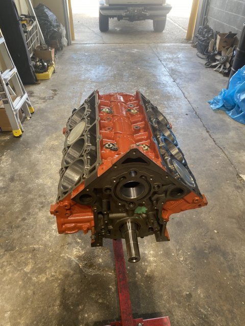

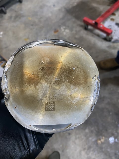

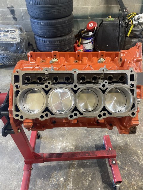

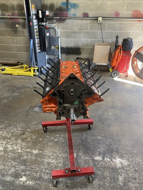

It's been a log 8 months, but shes finally close.
Daimond Hemi2k pistons 10.0:1
Cammotion PD 2 cam 228/242
Molnar power adder rods
Calhoun performance head porting
ATI 10%
and I guess Ill step down to a 3.09 pulley for start up/break-in

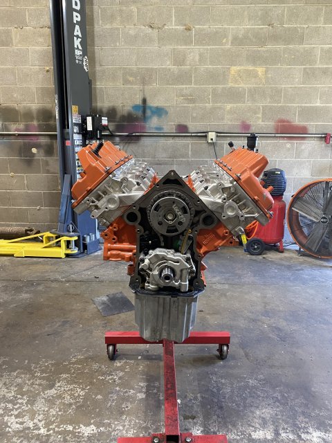

That's not a stock sump right?
11,710
19,832
BTW, looks great!

same camshaft that`s in my new build, you will notice more torque for sure.

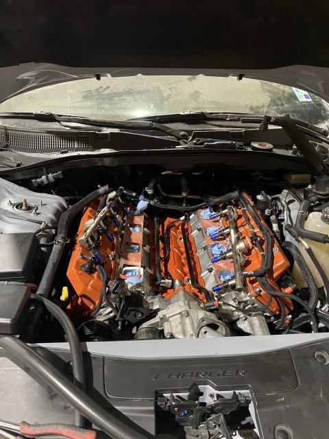

well, trans cooler lines and heater hoses kicked my butt a little more than expected.
close but another couple of days.
My goal next Tuesday so I can pick my son up from the airport in it, but I’m not going to rush it
maybe I can find some more free time soon 2A98A54A-44D5-4816-9950-655EEA1C2E7B.jpeg

Well, unfortunately I can't figure out how to post a video, but she's alive finally.
I added the ATI 10% lower and stepped up to a 3.09 upper. I'm seeing about 17psi but she for certain has more midrange than before.
Still got a few break in miles so I haven't beat on it yet, but traction is non existent even from an 80 roll. I'm happy the Michelin pilot sports are predictable haha
