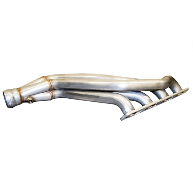

More specifically TSP headers.
has anyone installed them in car?
I’m planning to attempt this tomorrow. I’m pretty nervous about the upper bolts on the passenger side.
I didn’t plan this out and I have ARP 12pt bolts and a stud kit but I don’t think there is room for a ratcheting wrench, and I’m not sure there’s room for a box end wrench.
the nuts on my studs are locking nuts so it will be a long day one flat at a time with an open end wrench.
Never tried to remove the valve covers but that might be an option depending.....
wish me luck

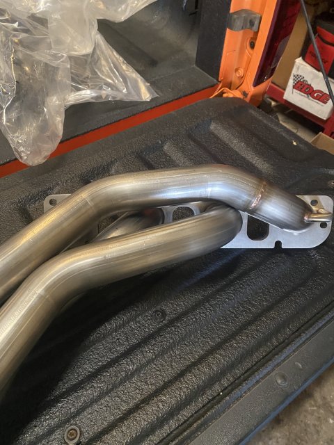

You should post pics of the headers. The pic I found shows lots of room. Only bolts on a 392 I did from the top were the front 2, all the rest were done from the bottom
I will be interested to see the difference at the track.
Simon proved you could get into the 8's with stock exhaust so I keep that in the back of my head

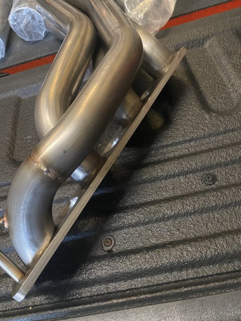

That pic is the drivers side header. I’m not worried about that one. It’s the other one haha.
I’ll get some pics when I get to the shop

D2326708-A4A0-4C1E-A6CF-6BE1C8C8E574.jpeg 47125030-177A-44F8-B2C2-6952412FB98A.jpeg
4,981
9,436

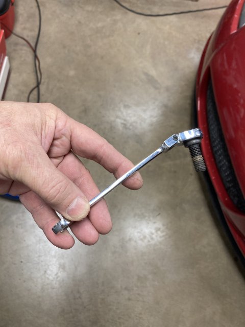

3,322
7,854
Get a flex head gear wrench, 10 mm is the ARP bolt size, I think stock is same size as well

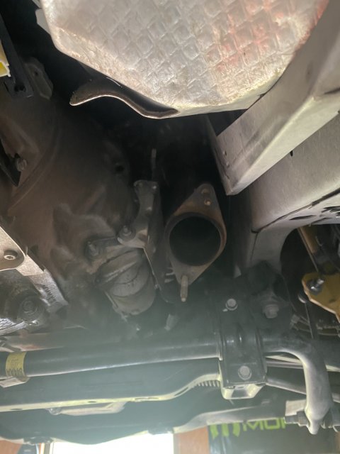

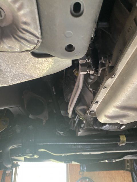

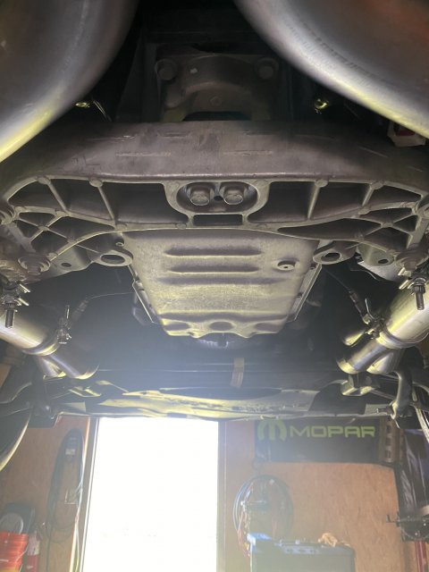

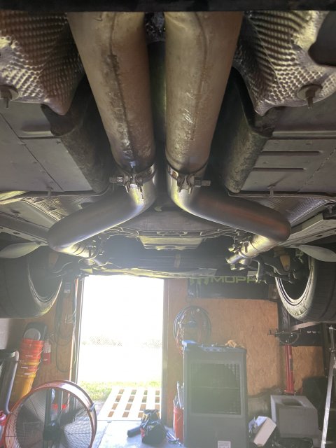

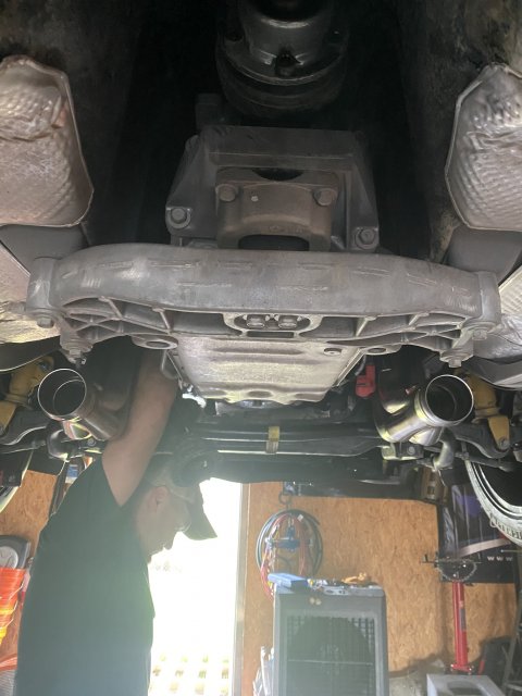

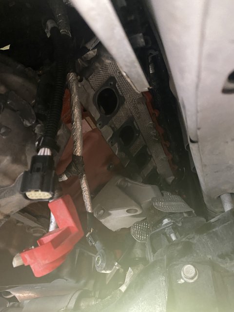

Thread Starter #16
Went much smoother than expected.
dropped K member to the last few threads on the bolts.
got all manifold and header bolts from the bottom.
I’m used to stock bolts being too long and the TSP kit did not come with bolts.
I had a set of 12pt ARH bolts I found in the tool box.
the worst part was I apparently only have 1 12pt 10mm socket
I really was surprised to not only finish today, but I didn’t even stay late!

On my old '13 mustang I found dropping the k frame made the job much easier. I would unbolt it and let it swing down leaving the steering and such attached. I didn't look much at doing that to the Charger but sounds like it helped you.
49,703
160,146
Not a big fan of the motor mounts. We spent a lot of time getting them back on when we installed the headers. When I took the headers back off I left the mounts on. Had to remove the knock sensors but had the headers off in a 3rd of the time it took 2 of us to but the headers on
Like everything once you do it a few times you figure out what works best
