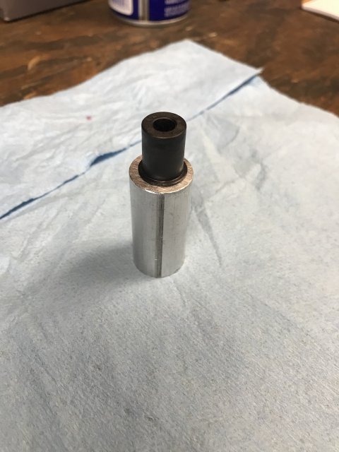

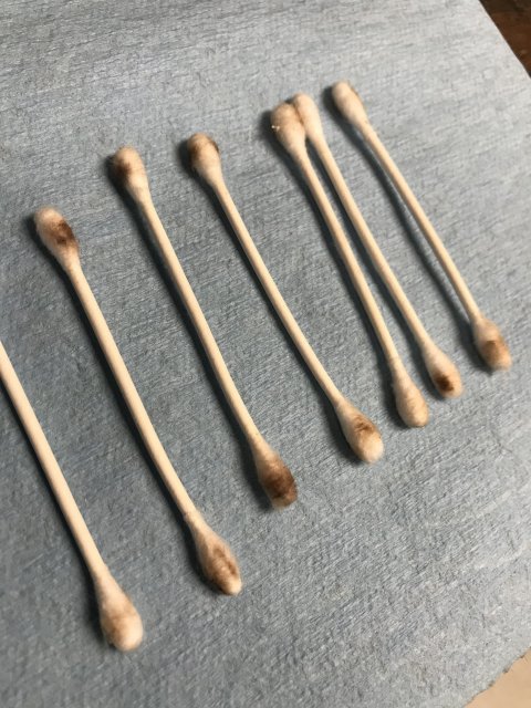

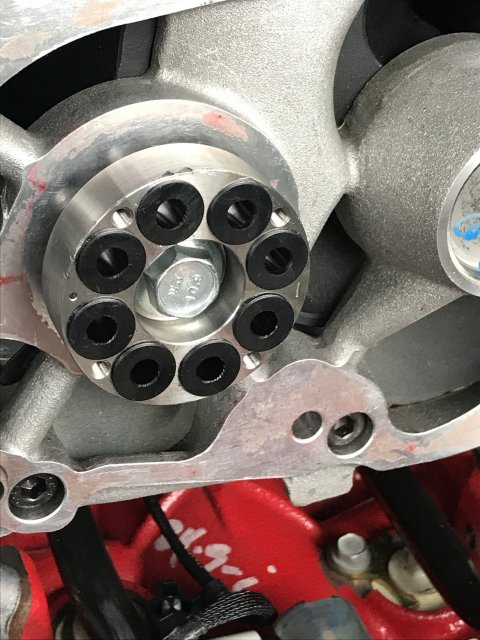

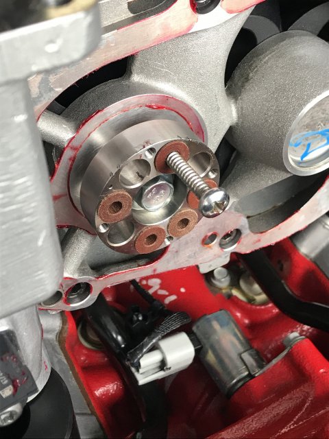

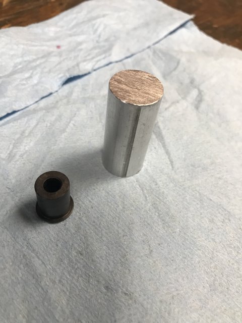

OK, pulled the blower again for the fourth time. I just wanted to see how the stock pulley would react to the hard plastic Jon Bond bushings since it was quiet with the Joker's cloth/resin "soft" bushings, whereas the Hellraiser still made the marbles sound (quieter) even with the soft bushings. Two things of note here: 1) Even with less than 50mi. on the Jokers bushings there was a substantial resin residue on the pins (That's not rust in the pictures). 2) Measured against the stock bushings, the Jon Bond bushings def had a bigger receiving hole and bigger outside diameter. On the stock and the Joker's bushings some fell out (on removal) or slipped in position (on installation) into the receiving holes in the coupler and some needed a slight push to go in. The Jon Bond bushings were all VERY TIGHT on install and needed to be lubed on the outside diameter of the bushing and the receiving bore in the coupler then "walked in" with authority with a hammer and large punch to cover the full flange of the bushing and bumped in flush.
RESULTS. Even with the larger receiving hole's on the Jon Bond bushings the supercharger with stock pulley is STILL QUIET. :) .
CONCLUSION. Well I kinda went around the block to get next door. I spent 900 bucks on the snout and went back to the stock pulley BUT now I have the harder more durable ceramic bearings and the quick change shaft so I don't have to pull the blower again if I want to do a pulley change, plus I learned alot.

I would have to say the stock or Jon Bond. I mean now I have the quiet and the longevity. My gut tells me the Joker's wouldn't stand up long term or would just get sloppy fast (But quiet. Lol.) I spoke with Jon and he did say they use a slightly bigger coupler pin when they rebuild, but I mean his bushings inner holes are like a .1000'th? ,1 1/2? or 2? over stock , so I mean slightly. But it's def there. The outside diam. was the real feel difference for now. I don't know about over time but I'd have to say that the screw I was using in the pic to get out some of the more stubborn bushings was easily pulled on with a pair of pliers to get them out. With the Jon Bond, I'd say I'd need a slide hammer behind the screw.
