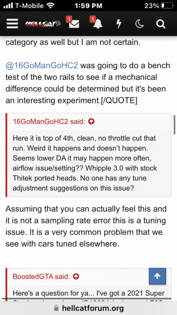

@16GoManGoHC2 was going to do a bench test of the two rails to see if a mechanical difference could be determined but it's been an interesting experiment.
Assuming that you can actually feel this and it is not a sampling rate error this is a tuning issue. It is a very common problem that we see with cars tuned elsewhere.

On the Yes, can actually feel it, see it on HP T log, and see it on Draggy runs even between the 3-4 shift and at the top of 4th cuts right around the 130 mark.
901AB55C-3807-49A5-BAB5-922423F7457A.jpeg 2C6A2165-F3A7-463F-8897-CC5B9B70F633.jpeg B0EE19BA-8489-48F7-8024-3640DF31F9C1.png
Here it is fixed by @jonx96 , gained me a 1/2 second on my 60-130 times. Took care of it within an hour of contacting him. I don’t know how people can wait 2-3 weeks for a reply or revision, summer would be over by the time one is tuned.

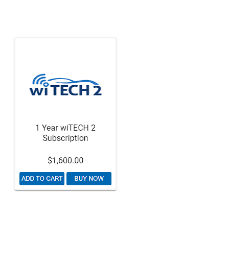

Mike I have 2 questions for you
1. The part number on the valve body and tcm seems to be the same. On my personal redeye I put a different trans in. I didn't swap Valve bodies. Well the trans was out of a 21 hellcat. I was having a few weird issues so I brought it to my dealer to flash it. So they did. They said it pulled down my vin but when I got home I still saw the soul of a hellcat and not a redeye config in the tcm. Do you know how the witech detects which config to load in?
2. I am debating about buying a witech. I really do not do a ton of installs I mostly do remote but it would be nice to have. The dealer seems to have very limited capabilities with theirs.
Assuming this is what I am looking for is these two items?

They can flash it to the most recent OS based on vin, that’s it. I had a buddy at the dealer came to my house to flash my TCM, since it’s out of a 16 charger. He couldn’t even change the vin on it, just flash it to the most recent OS based on the vin it was showing
5,574
4,612
#97
Witech is very limited. If your TCM had your vin on it, they should have been able to flash it to the most recent redeye OS. We need bench flashing support for the 8HP transmissions like we do with the PCM

@Jon-MooredPerformanceLLC i went through this. Valve bodies from Dodge come with the TCM. They are blanks. When we programmed mine we put into the system my VIN and it programmed it for that year. Once a VIN is written it cannot be re-programmed by Mopar tools, the functionality simply does not exist. To re-write a vin to a TCM that is already encoded you will need a bench harness. Seqway to:
I am looking at said bench harnesses but they are about 7k in price :(
