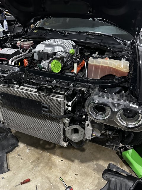

Getting ready. Found a bolt from my crash beam I thought I lost 4 years ago in the heat exchanger air duct lol. You can see the worm clamps where I’ve had this all apart before

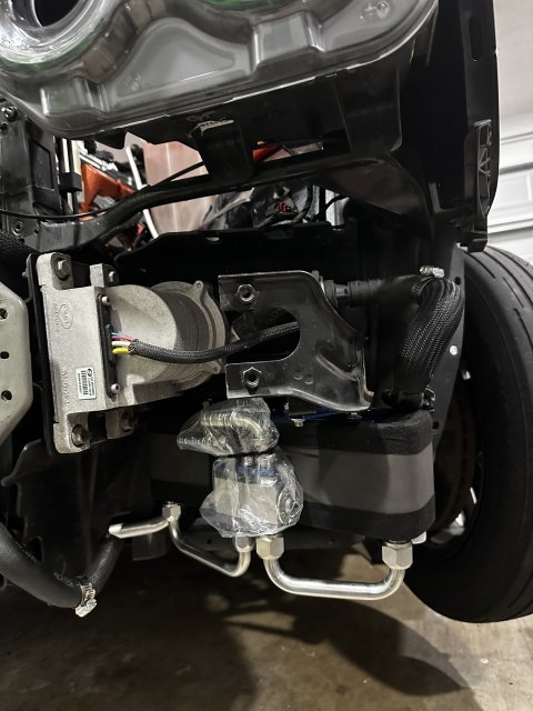

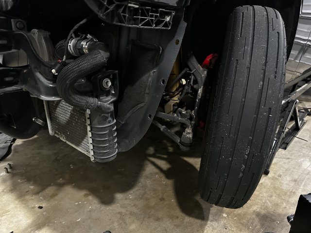

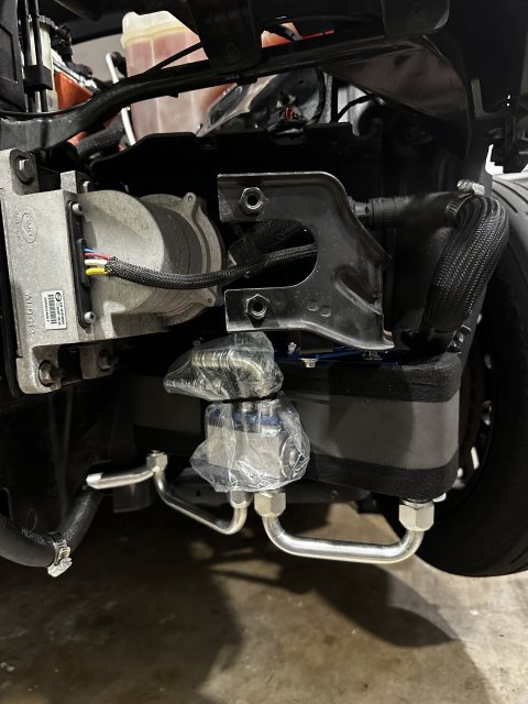

Thread Starter #16
5,463
4,508
Thread Starter #17
Getting mocked up. If you already drilled out the spot welds on your crash beam (like I did) I recommend pulling it completely, makes life a lot easier
