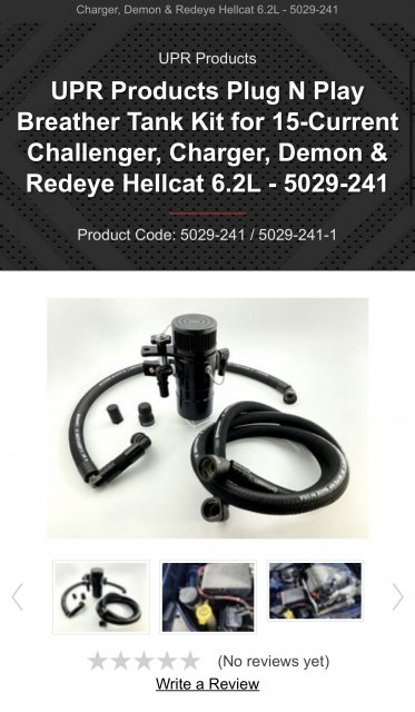

I misunderstood @fumanchu182 i know what you’re asking about now. You want the UPR dual pass BREATHER can, that comes with the block off for the snout. I have been told a tuner can tune out the sensor that goes into the intake on passenger side. Both valve covers are Plummer into the can. It’s a really nice setup

This is the one you want @fumanchu182 , comes with plugs and looks like the price went way down - was $400 when I was looking at it

Nothing goes back in through the superchsrger2 engine - vents out top. But tuner needs to tune out sensor on passenger side that going into intake

I have just the standard version of this and a breather on oil filler

Don’t mess with a custom setup, this one just works unless you’re pulling the cabin air filter box and mounting a huge breather can back there, will still have to tune sensor out. I’m sure @jonx96 csn take care of that, just not sure exactly how it’s done. But UPR should be able to provide some insight or HHP maybe
