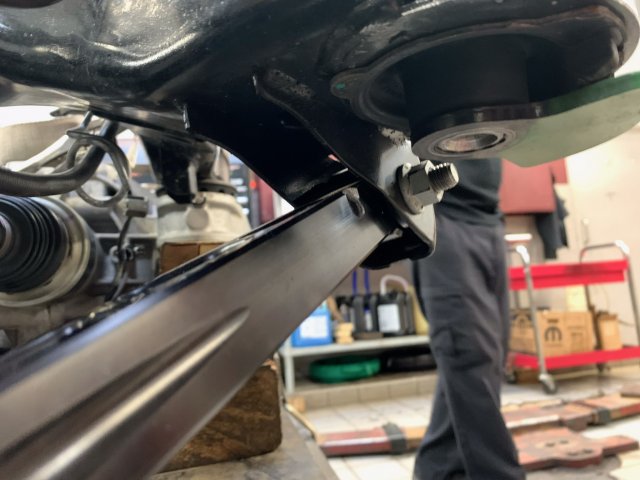

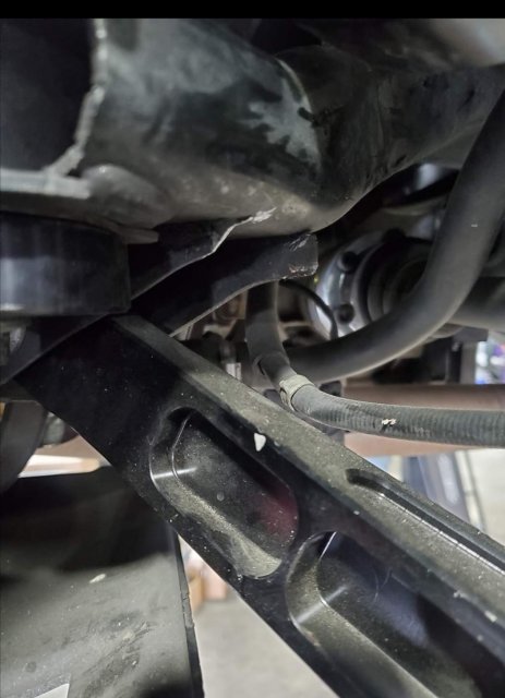

It looks like later in the thread someone found the lower arm contacting also.
6,809
43,189
An AAD arm WILL NOT contact, but if you have a set of arms that are NOT made by AAD, but copied by others, it likely makes contact. Maybe see it better here...

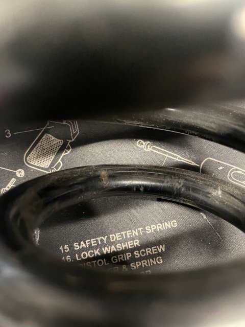

Thank you all for the insight. Went back in and looked it all over. Didn’t see any pinch weld damage on either side. “Clunk” has been only really on the rear driver side. Found the spring not in the cup on driver side. I think.
Is my markup in the photo correct? Let me knownyour thoughts. If anyone has a pick of how it should look please post up. Thank you all again for the insight.
3,550
8,648
Thread Starter #28
Spent all night on garage floor struggle bus with this shit. I need a lift. Anyway it's now in the isolator cup properly and not a damn sound. All feels well!

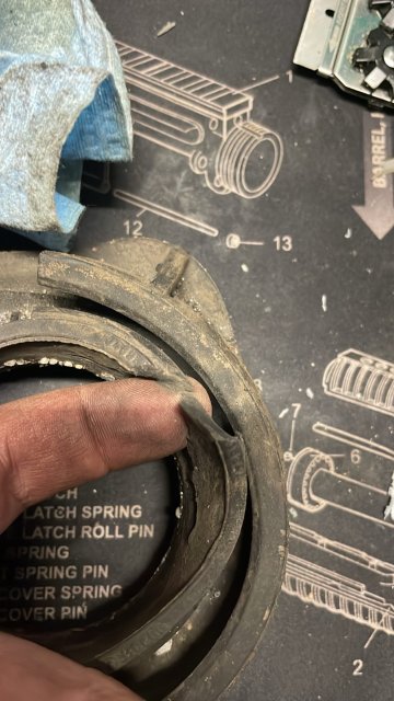

Whoring up my own thread. Shortly after clicking came back… hoping this was the issue…
5A245163-DEEA-45E2-B1CB-145ADF9A18C3.jpeg 2BDD280C-4E69-4F3A-927A-6BCD33507770.jpeg
