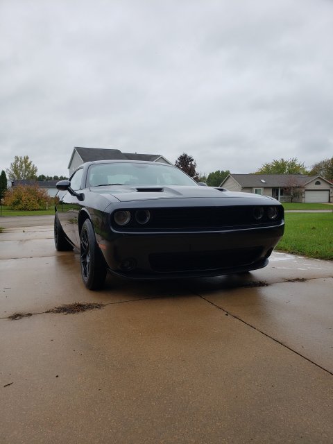

I have had no issues with mine on the street.. I don't go around corners fast and I can't tell the difference from the stockers driving back and forth to the track. Had them on the Challenger last weekend in the rain and they did fine. Will be driving the Challenger to the track with them today

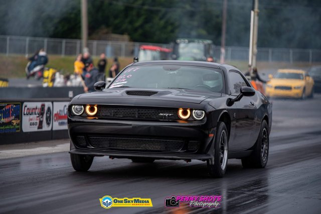

They are just fine. If youre worried about load rating then get the S/R, I’m not, heres why. M&H doesnt post a load rating on their website for their DOT radial. Hoosier doesnt post a load rating on their website for their DOT radial. 🤷🏻‍♂️ I drove to Cecil and back which is 63 miles each way, made multple passes and even got this beautiful picture.
Had zero issues at the track. Proper inflation plus driving like a normal human and you will have no problems. Would I daily them? No.

That is a nice pic !
