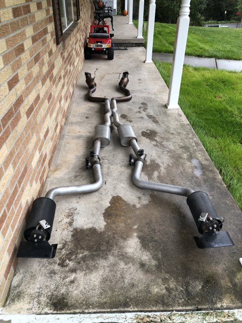

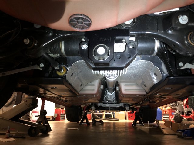

Did DS swap today, complete exhaust system took about 20 minutes to remove alone, collectors to tail pipe tips, 4 nuts 4 bolts. Didn’t do trans swap though, wanting to see if DS swap alone produces any unwanted NVH and also last track night of the year coming up this Friday night

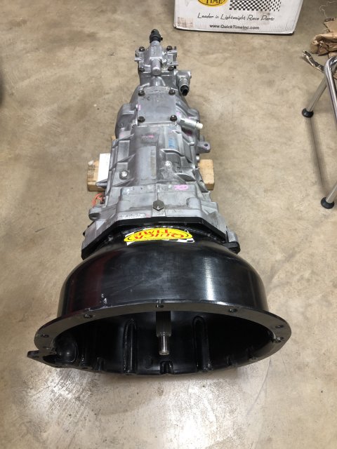

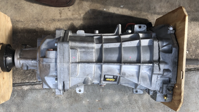

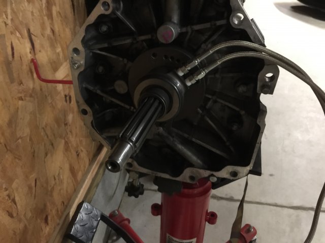

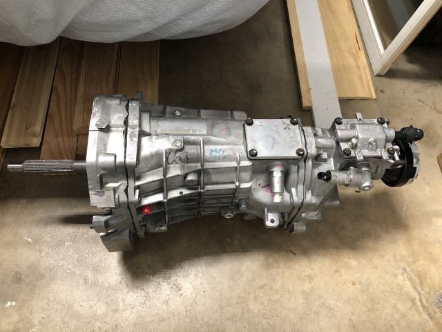

Tranny is ready to go though

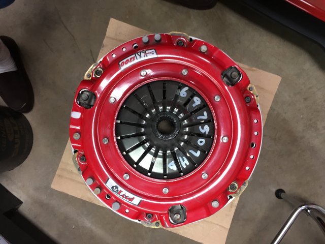

8DD7841E-BF60-4141-B432-D2EFC3671655.jpeg Going to use The McLeod RXT1200HD
Hoping to have time before first snow here and salt cinders are out to change tyranny alone and then over winter change clutch, flywheel (alum) and bell along with some motor enhancements

Used the same bell-housing and RXT 1000 clutch. 3 years ago and still going strong. I don‘t know if you are using the stock release bearing/slave cylinder, but as I recall it needs a shim for proper throw with that clutch. I used an aftermarket HRB that came with shims. Also checked the runout on the bellhousing.

Double check TO bearing clearance. Had my trans out 3 times in the old car to get it right. McLeod built the clutch too short. Wasn't an issue until speed shifting.

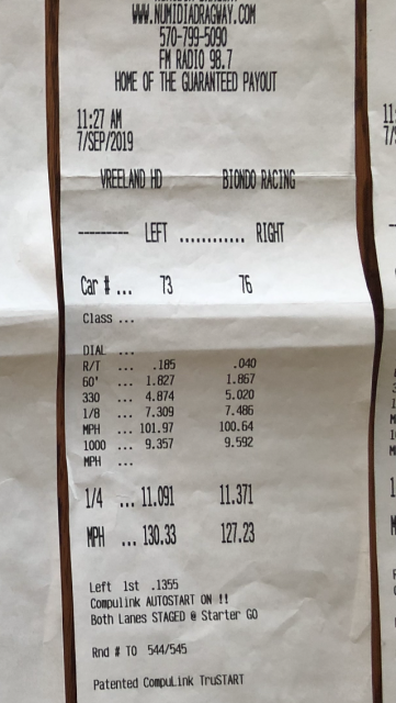

My friend put this RXT1200 in his 800 wheel mustang last month with new engine and trans. Pedal pressure hardly different then stock, no chatter but he says there’s no slipping it it grabs hard. Says it doesn’t bother him street driving, the car is his daily but on the track he’s still getting used to launching it. His best time the day this video taken was a 10.82. When we ran side by did, He did a 11.0 me a 11.3 He’s running a 2 step, each shift he pulled a 1/4 car on me, was just off his bumper across the line.
Here is our run that day, no video though we where both in our cars lol
He’s car 73 me 76

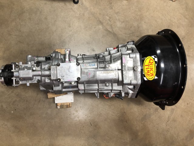

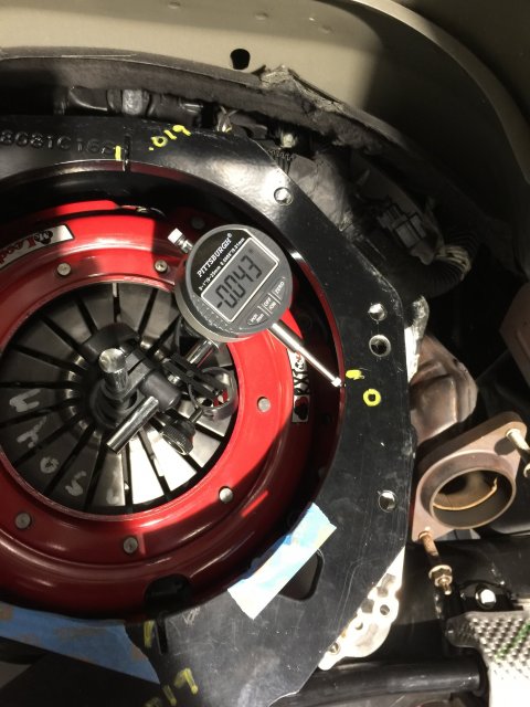

042 how was QuickTime bell run out wise as is out of box? You check it’s angular accuracy also? (Trans Face flatness). Did you have to get offset dowels to get it within runout spec?
I also dial a new bell in, sometimes it takes all day and SUCKS, bell gets heavy after putting it on and off a dozen times lol. Just wondering to look forward to this with this bell or not??

just checked the runout as I recall. Was concerned I might need offset dowels when first installed, but was within spec once torqued down.

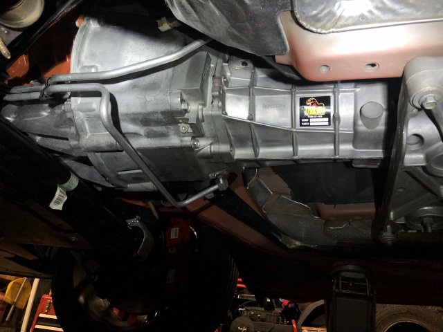

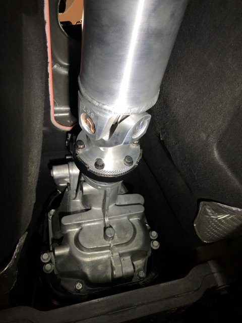

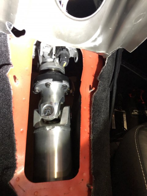

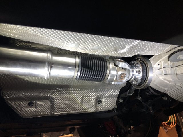

Ok, so ended up playing musical drive shaft with the DSS, ended up taking it out and ordering a Wiles. During the wait swapped in just the Tranzilla, left stock clutch and bell in place for now. Wiles a nice piece but not a drop in with a Barton, had to mod the Barton to get it to clear but it’s doable and worth it, Barton shifts the Tranzilla nice. Took the spring out of the 5th 6th gate while it was out, definitely like it better with easier to get to 5th gear.

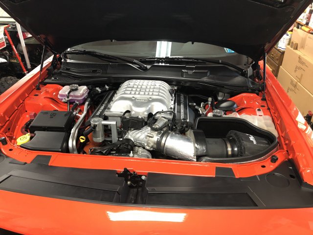

First off my Nitto 315-35-20 05r’s where like Kojack’s head but where giving me consistent 11.6 street pulls would do nothing but spin spin spin, 12.3 street 1/4’s but it’s cooled off here and test area surface cold. And BTW installed blower insulator spacers and blankets while down so maybe making a bit more power as well as the car feels like an animal with this ratio but just can’t hook up. So put my only half worn out 275-30-20 ET Street SS’s on, well their totally worn out now as they spin even easier then the bald nitto’s did. So ordered a new set of 315 05r’s and put them on yesterday in anticipation of going to the track today and see if I could hook up on a sticky surface and see if this trans is a keeper or not. Well is 30F here at 8am and temps only predicted to be 40-44 at best at 3pm so we cancelled the 2 hour 1 way ride to the track :( bummer.

Some pictures

Nice work! What did you have to do to Barton to fit? Grind to clear u-joint coupler? (pics?). No mention of vibration with this driveshaft. Assume all good. Good luck with this setup, hope all comes together for the better when weather permits. Again, (y).
