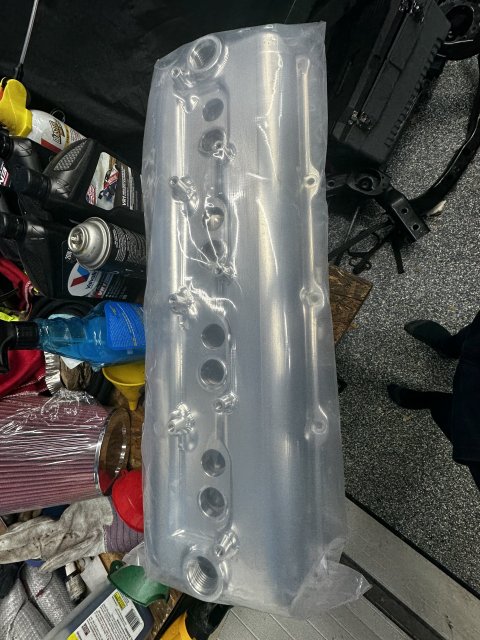

Manton new valve covers fit like a glove.

use factory gaskets ready to bolt on. Can’t ask for a better product for the price.
don’t buy the copies buy the original

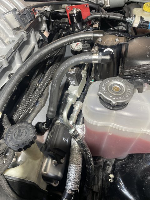

Semi buttoned up. New an lines on driver side. Spent 48 hours thrashing, wouldn't have it any other way. Time for bed, gonna do the coolant side during the week.

Weld a 10 a fitting to pump and put on a remote tank. That’s how the old 6.1’s are
yup, could just buy the 6.1 pimp and use a remote reservoir. I got it modified to work with my power steering.

Yep, exactly. I’m selling a hellcat pump with a remote fitting on it, not a 6.1 pump. Tank is from a 6.1 or 6.4, has the correct feed and return port sizes that will work with hellcat lines.

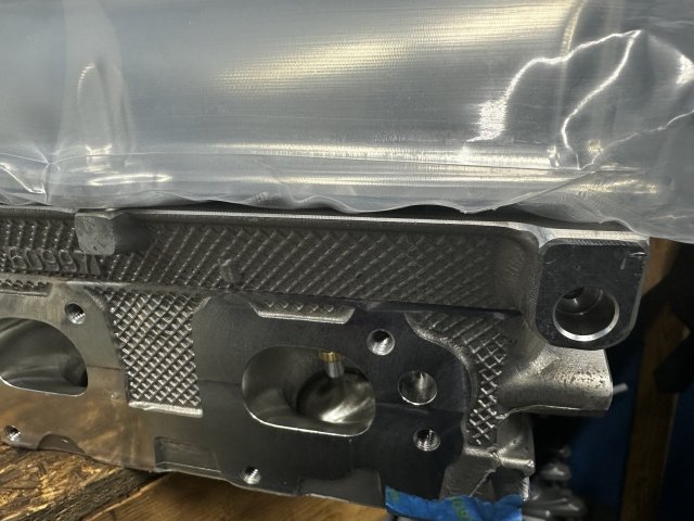

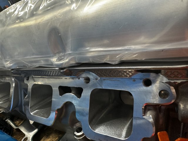

I had to modify my new Cornerstone covers to work with the power steering. I haven't seen any kits to eliminate the power steering on a hellcat yet.
Robert, What portion specifically had to be modified? I have the Cornerstone covers but no plans to have HHP install them until the new block is finalized.
Any pics of what had to be changed?
RGPIII
#983
1,016
1,888
Bridgeville
the front edge needs to be milled down pretty significantly. I've got the 6.1 pump and remote reservoir ordered.
