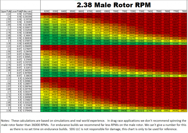

As title says, im inquiring what max rpm for a stock blower would be. Ive heard around 20-21k safely. Other have stated higher. My concern is obviously the faster you spin it the more heat it makes this negating the process. Is tbat the only concern? Secondly what kind of iats (how high) are we looking to run safely? Of course the lower the better. Im just trying to wrap my head around a few things. With the Interchiller stage 2 i never see high IATs. Just wondering if thats the limiting factor. So many different opinions out there. TIA
49,703
160,120
Here is the chart with pulley sizes. Stay out of the red

Dang so a 2.55 upper and stock lower im pretty much tapped. Grrr

Stock lowers are 8.18 for your calculations.
Gotcha. So to stay out of the red (36k) i rly couldnt push it much more unless im misreading the chart

so is this chart (6200 -7800) engine rom or the rotor rpm? I’ve seen this chart before, just never got clarification on it
top is engine rpm, in the boxes is rotor rpm
Dude you’re spinning that plenty fast with a 2.55 lol

I agree @BULL. I run a 2.69 upper only and trap 142, there’s more in it for sure once I get a chiller. I refuse to spin it much faster than that, maybe the 2.66 that satera has but that’s it, I don’t like that it’s anti ed pulley that I have for starters on the stock blower. There’s plenty of other ways to make more boost and more power on a stock blower than spinning it faster than that

10% and a 2.70 upper... 😂
I have just a 2.55 upper which appears to be very similar to 2.7 upper 10% lower
