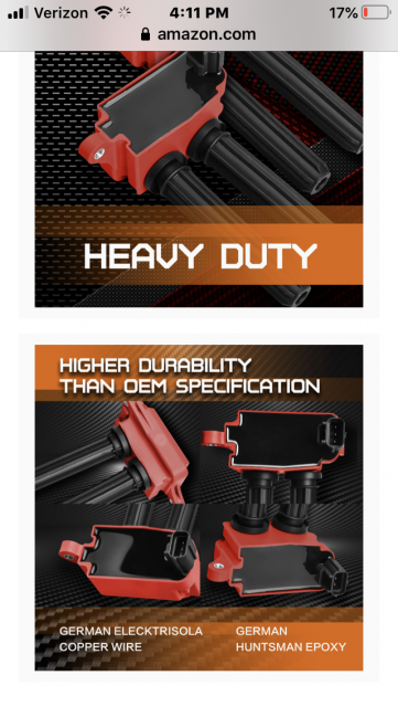

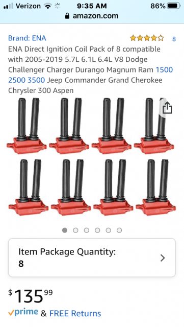

Like earlier in the post I posted these, these are the ones he used, made by MSD for this company, same part as MSD part but without MSD logo on them for half the price
These coil packs ^^ are the cheapest I've seen, My question on coil packs is what is the voltage output ?
I read some where the stock is 25k volts. Not sure if that's true. Defiantly don't want less volts than stock.
Accel is 33k volts, $428
MSD is 36k volts, $481
Performance Distributors SOS is 40k volts, $379

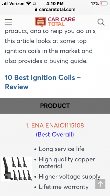

Unfortunately don’t know voltage on these, their supposedly made by MSD.
Myself, I’d probably buy genuine MSD, I come from the school of hard knocks and you get what you pay for. For testing purposes or back up spares I’d use the cheap ones, for performance upgrade, longevity, and especially high boost applications I’d use genuine MSD

I agree, you get what you pay for normally, that's why, if I needed them, would buy the PD's SOS (Sultan of Spark) with the 40k volts at $379, not bad compared to the others.
I've noticed that if they don't say the voltage, it's probably not that impressive.
