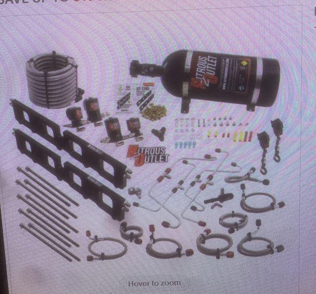

Alright, so considering nitrous. Probably 130 jets. Spacer kit. Don’t want to spin the blower any faster 2.69 upper. Thoughts? Will she handle it? Pros? Cons? Send it? Thanks guys, looking for some honest, solid advice and opinions here. Thanks

They have a real nice kit out now, only reason I’m considering it. I ringed blower spacers, and then I can sell my FI spacers that Are on the car now

Yeah, they just come from the fuel jet, that’s why there’s 2 solenoids, 1 for nitrous 1 for fuel. Or with the spacer system, 4
I have this kit it’s a very nice kit and can easily be used with any blower. Even a 50 shot makes a huge difference on our cars. Jon is looking to do nos this week.
you could drop to a 2.72 upper and go faster using the nitrous.
