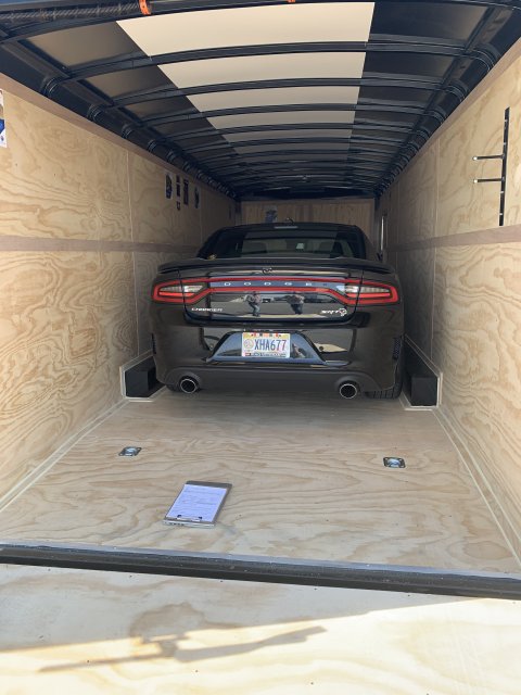

@hellno you better put your big girl panties on for this weekend!
I got my trailer tonight....getting ready for this weekend.
I hope your not racing with those tires ?
Nice trailer though.
