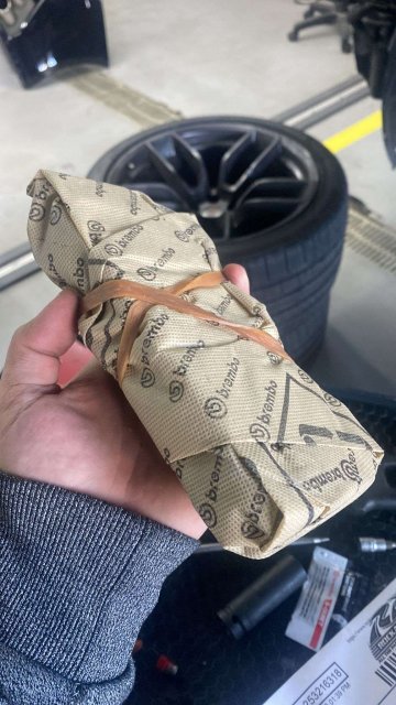

Hello i have ordered front red Brembo brake pads for my 18 Hellcat Widebody.
We have installed them on the professional garage.
After a driving on the highway the pads destroyed my Rotors instantly after 100 miles and i got my right caliper got off.
So i was nearly having an accident since the brake system heated up and the bolts that holding the caliper just broke.
Installation was correct and there was no problem with the initial original brake pads before.
what do you guys suggest ? im going to sue the Brembo for making this pads.
Im posting the photos check it out guys 20231025_200105.jpg IMG-20231012-WA0004.jpg 20231023_122603.jpg 20231023_163239.jpg 20231023_163231.jpg 20231023_122606.jpg

both left and right rotors got burnt down sadly. looks like brake pad failure to me what else can be guys ?
notice how all 4 of the front brake pads got cracked down after 100miles is that normal ?

did the calipers come loose ??? the fact that they rubbed the wheel looks so
yes thats what happened from the brake pads sticking too hard
