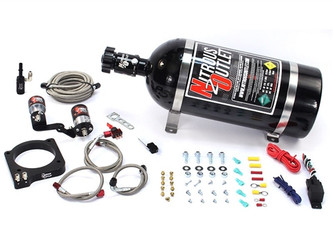

This is the system that is used for "Top Cat" Challenger. the description gives some good info about how NOS is set up.
https://highhorseperformance.com/ni...wk-ram-trx-durango-srt-hellcat-6-2l-00-10158/
Description
Flow Up To 400HP. This system comes out of the box with everything you need to spray 200HP, but can spray up to 400HP with additional jetting.
Superior Atomization. This injection plate has 6 specially designed nitrous and fuel discharge ports that completely saturate the air intake charge with the best atomized mixture possible. For higher horsepower levels proper distribution into the air stream is critical for even cylinder to cylinder distribution.
Wet Nitrous Plate. This system includes a billet aluminum plate to fit the Dodge Hellcat supercharger snout and is capable of flowing up to 400 HP of nitrous. Each billet plate has a black anodized finish with CNC engraved logo and fuel/nitrous labels.
Vehicle Specific. The Nitrous Outlet Vehicle Specific Nitrous system is the safest, best fitting, and most tuner friendly system available.This system is designed specifically for the all new Dodge Hellcat, including an intake specific solenoid bracket, fuel rail adapter for aftermarket fuel rails, and application specific hardware for the best fitment and cleanest install on the market.
Complete System. This system includes all of the necessary components; billet aluminum nitrous plate, 50-100-150-200 HP jetting, hardware, and wiring to properly install a wet nitrous system on your vehicle.
Wide Open Throttle Activation. This system includes a wide open throttle (WOT) switch that only allows the system to be activated when the motor is at full throttle. This safety feature will help prevent engine damage.
Application. This system is specifically designed to fit the 2015+ Dodge Hellcat Supercharger snout and has vehicle specific solenoid brackets.
Flow Up To 400 HP Anodized Billet Aluminum Nitrous Plate 400+HP Solenoids Fuel Rail Adapter E85 Compatible With Different Jetting All Hardware, Electrical, Bracket, and Jetting Included Includes Jetting for 50-100-150-200 HP

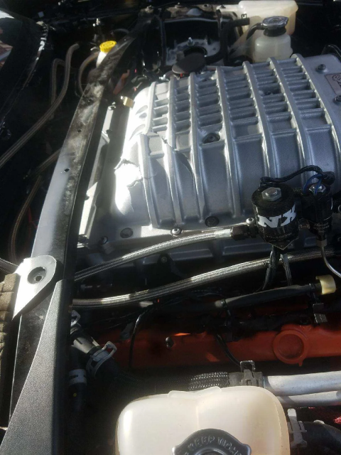

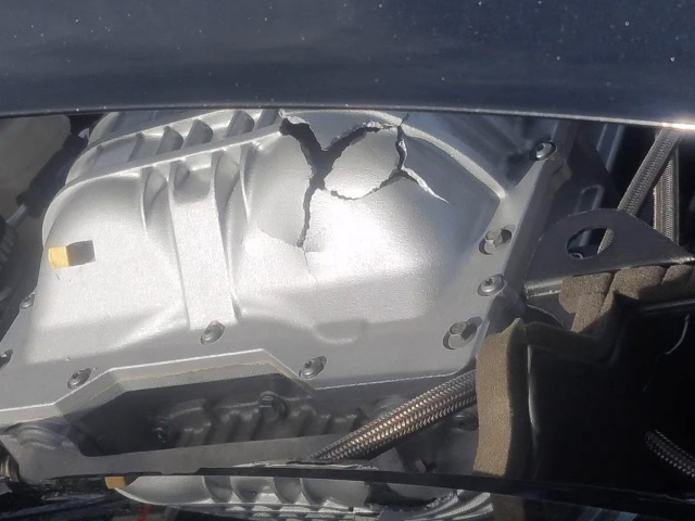

Well, I heard of 5 but it's probably more. " I have plenty of superchargers " he said!

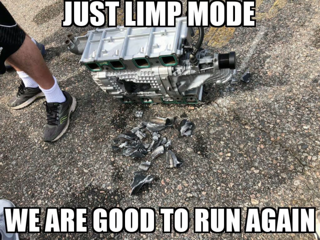

The one I saw happen is the 1st picture and that SC blasted right through the hood and that Car which also had a brand new wrap on it! Totally grenaded, because he forget to turn off the NOS during a Burn out! The small shots like 150 is really max, But he was "Max effort", in seeing how many he could blow up.I think he holds the World record for the most blown up superchargers.
That 1st one the guys vacuumed everything up and he went home and got another one. They had that installed, but he missed his race and was done and out. But he got his very own Meme! I'll have to find the hood pic.
