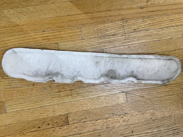

And not to sidetrack, but any flak from tracks for the chiller dropping water on the surface?
There is an absorbent pad under the chiller to catch the condensation.
11,710
19,832
That I did not know
#1330
428
696
Saint Paul
Dodge SRT Demon
That I did not know
F34317A9-5077-40E1-AC82-3816B95F6682.jpeg If the adhesive fails and pad is out of place under the chiller.
Your car can turn into a one wheel wonder
If it gets hot out and the water drips down through the plastic covers on to the track.
