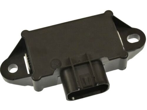

Got a question pertaining to the fuel control of a 2015 SRT392 Challenger. I am building a modern 70 RR with all 2015 Challenger drivetrain / Electronics / all wiring ...etc. My question is...Does the 2015 Challenger SRT392 have a separate Fuel Pump Control Module? (Part # 68193711AC). All other Challenger Models have this Fuel Pump Control Module mounted in the truck on the drivers side . Half of the MOPAR parts web sites say that Part # 68193711AC DOES NOT FIT my Vin # . Can anyone shed light on this???

I have called the dealers. A few.....some said No Fuel Pump Control Module....the others said .Yes it has one .
THATS WHY I posted here....HOPING someone could assist.
My project is a scratch build so I have nothing to compare it to.

I have the VIN of the car MY parts came from . It's an SRT392. 1/2 the Mopar parts sites say the 392SRT HAS a fpcm.....the other 1/2 sites says IT DOES NOT

just seen this an went on pro demand an there is no fpcm used on both 6.4 an 5.7 2015 challengers. doubled checked wiring diagrams. in hellcats they have them mounted in trunk on right side.

Thanks Oilburner.....I appreciate your assistance with the "Pro". When it comes time to "Start" this project up Ill be confident to know that I dont need the fpcm.

even though there is no fuel pressure control module, you still need pressure to be regulated so I suggest you use same fuel pump module that the engine an wiring came from. the regulator will be integral being that its a single line system.

The fuel pump regulator is built into the siphon pump assembly on the right side of the fuel tank.
