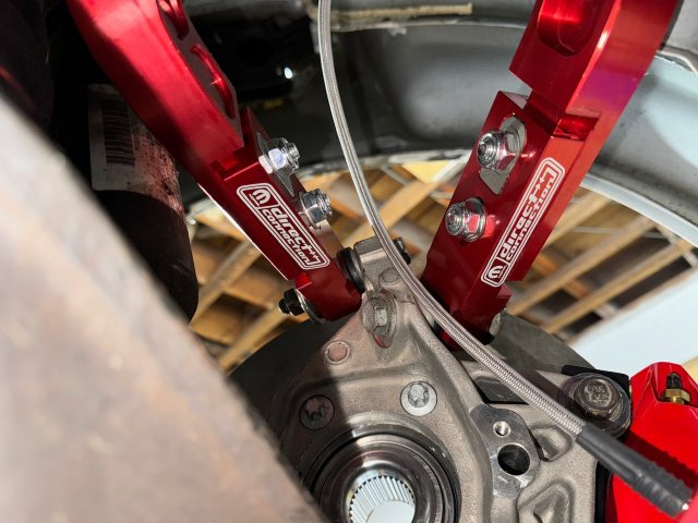

Showing off my DC bling bling
3,555
8,657

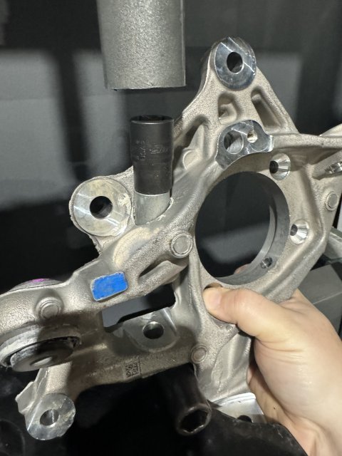

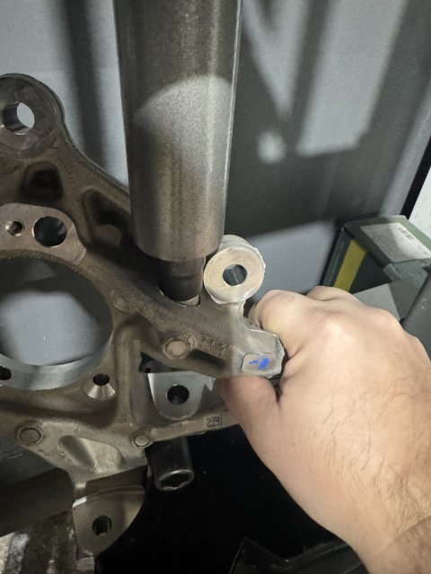

Yes these are the zero camber DC knuckles
Some assembly required

I need to get those. Strange they don’t install the metal bushing/collar

Why? Changing out most things on these cars are not that hard. I think people that don't even know how to change their oil want to make upgrades and start the rumors everything is hard. You can change the arms out without dropping the cradle out of the car if you do one side at a time

I had my knuckles off to put new hubs and longer wheel studs in, very easy to do. Rush I got these though, they come with new hubs
