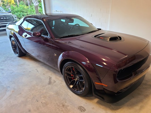

What kind of succes or lack of have you had with ceramic coatings?
Do you think that it's worth the expense?
What do you suggest ILO ceramic?
Picture for illustration purposes only.
