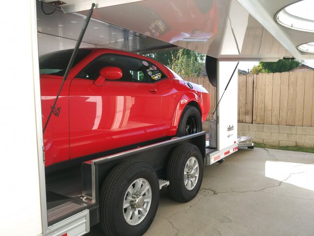

Get the 6' tall full access door. I have a 5' and will NEVER do that again. Get 16" wheels. Period. A 4 or 5' ramp extension is a must if ordering. Also with Intech you can sign a waiver and they will build it 3-1/2" wider. I would do that if I had a chance to do over.
I bought from Joe @ KB Trailer Sales.

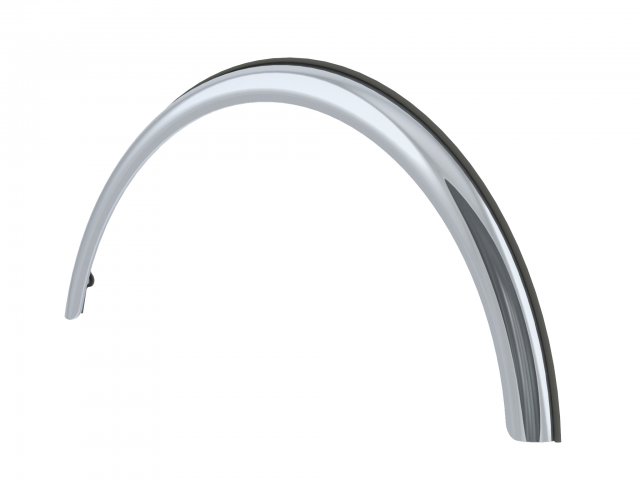

I guess I will have to explain this so the width police can let it go. Trailer is legal width with the Fenderetts that go around the wheel wells on the outside of the trailer. Sign the waiver and they will build the SHEET METAL SIDES at legal width to give you a little more room inside. I assume they move the interior wheel wells out a bit as well which can be very helpful if you have a wide body or similar. Then if you get stopped by Police or DOT or whomever you would have to unscrew the Fenderetts to be legal. I was guessing at 3-1/2”. It might be less. fenderette.jpg

Okay, that's a bit different than what I first thought, based on post number 45.
Full width (102") enclosed trailers aren't anything unusual. It was having to sign a waiver that threw me off.
