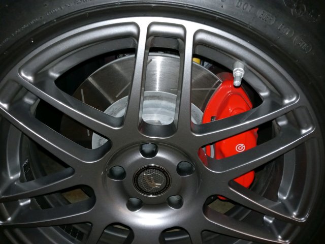

Maybe the Pads are not bedded in yet? My Brakes are almost too powerful if anything (all stock including pads). My Friends just put all the AAD stuff and cradle lockouts on a RedEye a couple weeks ago. They adjusted the rear camber at the track yesterday. Once it is aligned you can just change out the numbered shims using basic math to make adjustments.

600 miles and 67 passes
