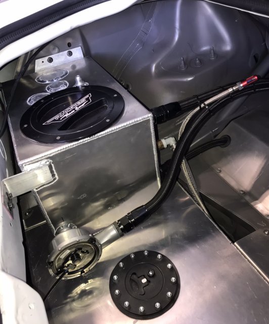

Hey guys, I’m installing a half moon PNR trunk ice box. Looking for advice on where/how to plumb it? Which lines, which side of the car, etc. Any info would be greatly appreciate (and pics). Thanks!

When I had mine, I popped out one of the trunk plugs and ran the lines through it, one on each side of the car up to the back of the blower. I used 1 inch lines for the best volume.
3,311
10,552
My first shot at that taught me a lesson. Knocking out the big drain plug on the passenger side was the fast and easy way to make a opening. Problem is now you have a big opening at the low point back there. Stray ice cubes are like mice. They scurry around and hide behind the tank where they melt. You now have water coming out of that drain hole at the starting line and the track officials go bananas. I suggest drilling individual holes that you can grommet in the rear facing side of the fender well on the drivers side and run the hoses over the top of that, inside under the plastic liner.

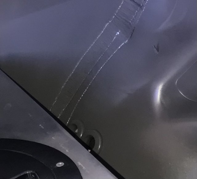

I don’t have a good picture but possibly these will help. I’m not using them now but you can see the two grommeted holes in the fender well behind the new ice box I’m using now. Those were used when I had that side mounted PNR. D67A15C8-C402-4FD8-B714-B3BBAAF104BD.jpeg C7F5DA71-AB43-4027-A5C4-119229C6086E.jpeg

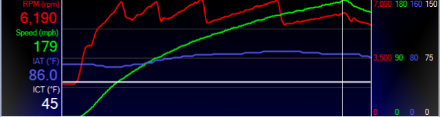

Here's a chart of my IAT's (blue line) on one of my passes this year. This was with a 3.8L Whipple making 24-26 psi, ambient was 82F, no nitrous.
ICT 45F (didn't change until after the pass)
Starting IAT 72F
Peak IAT 90F just over 6 seconds into the run
End IAT 86F
For MAT, it calculates about 20 degrees higher than IAT at these lower temps with ending MAT at 104F.
I use a 7 gallon ice tank with a EWP150 on the tank and the factory pump up front.
