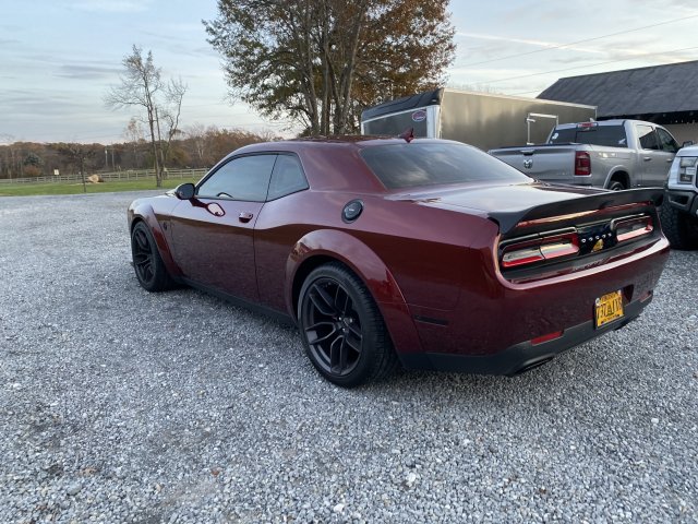

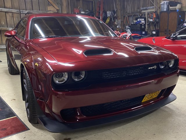

Wait wait I love the 2 SCOOP and wide ass kinda like Boobs and buttocks lol
6C6F92F6-A2DD-4F1E-AF45-2A97BB55410A.jpeg D2603BE9-58AA-4DE0-B936-238F9F3E8296.jpeg
