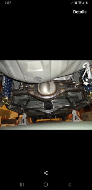

“The bigger question”.... also takes near 300 lbs out of the car and costs close to a optimized DSS/Gforce 9” rear with all the good stuff. 0F4083EC-5EC5-4C68-90B0-3D126DB615C9.jpeg

Right, I've been following your thread. Will the ride be something you can drive around on the street with? I can't see what the shocks are there. Means a gas tank change as well I think.

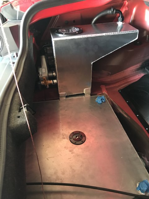

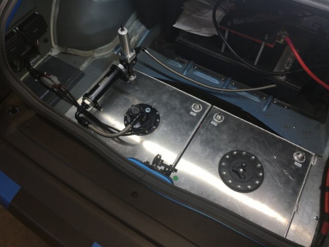

Yes the gas tank gets relocated into the trunk. I’m using a 15 gallon custom aluminum tank with a sump and external fuel pump. Internal pump systems are a option also. The 15 gallon size keeps it level with the top of the tire well and no cutting is necessary. This size would allow me to cover it if I want and you wouldn’t even know it’s there. Mine compared to another that is larger and using a Holly internal system. C57E69AF-D31A-466B-AB41-4911FECF773C.jpeg E10C16CC-A50C-493F-9B47-F2FAB1E396C6.jpeg

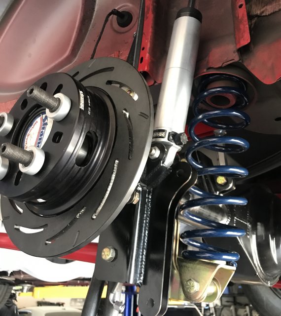

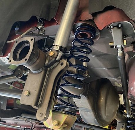

This is the 2015 DragPak setup. It uses independent springs that come in different weights that are interchangeable. We’re using heavier springs than were used in the lighter Dragpaks. The shocks are Strange manual adjustables. I don’t think the ride is going to be a issue for normal around town driving along as you keep the cornering within what a purpose built drag car might be expected to do. 6D0FE725-9C80-45B7-BA24-41E17FF6C2DC.jpeg DA680F0E-97DA-423F-8C28-C1A56DDBEA3B.jpeg

This is the 2015 DragPak setup. It uses independent springs that come in different weights that are interchangeable. We’re using heavier springs than were used in the lighter Dragpaks. The shocks are Strange manual adjustables. I don’t think the ride is going to be a issue for normal around town driving along as you keep the cornering writhing what a purpose built drag car might be expected to do. View attachment 31159 View attachment 31160
