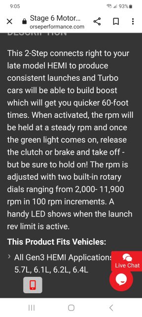

HHP also sold me the wrong burnbox before lol. All of that stuff they list is just copied and pasted from the supplier and not kept up to date

I know it says 2k rpm everywhere but line fuman said that could be wrong. If it goes down to 1500 rpm should be perfect
I went directly to them to get it installed.
As I posted earlier, they told me that the lowest rpm was 2K.
Now it it's been changed, that would be great.
You can figure it out.
