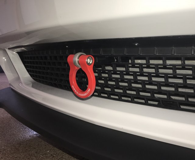

2019 Widebody Hellcat
Track season around corner..
Tow hook and tie down points by ZL1
QUALITY PARTS, nice packing and quick shipping! 👍

Some work for sure to install this tow hook!

All done. Ready for track!
Did you have to take the entire front valance off? Or just the underbody tray?

I watched their video on how to install the front tow hook. They didn't take anything off the front - none of the fascia - they took off the pans and drilled up from the bottom. It looked a little tricky as far as getting the hook's shaft to come through the fascia grill without cutting. I asked Zl-1 about this a couple of months ago and was not fully reassured coming up from the bottom would work on a Red Eye - that maybe there was an oil cooler radiator in the way?
Anyone done it the way they show on a Red Eye?
And on the subject, is a rear hook a better location?
I have the 2020 Super Stock. So on mine..Only bottom grill had to come off front..
Complete underbelly and full spoiler removal was necessary though. Like 25 plastic rivets had to be drilled out and replaced. Not to mention countless screws and pushpins...Dodge should have this built in like my other cars!
If it's the video I watched, it was done on a Charger...and not a Hellcat Charger. So no intercooler, and plenty of room (compared to the Challengers).
The issue is there isn't enough room to drill 2 straight holes up thru the crash bar without risking damage to the intercooler and such.
After seeing WidebodyCat's pics, I thought there might be a glimmer of hope. But reading what he had to go thru, Seems it might be as bad as just taking the nose off and being done with it.
As to the rear hook location, there is a different mount needed for it. You drill a hole thru your rear lower bumper (behind the license plate) and then drill into the rear crash bar from there.
After my struggles with the front, I haven't even attempted to look at the rear yet.
Thanks. I was hoping that maybe I just needed a bit more disassembly to get mine on, but sounds like it's gonna be a project.
I'll have to decide what direction to go. I'd hate to drill all those out and remove them...only to find out I still need to take the nose off.
If you don't mind, may I ask where you got the replacement rivets?
Im not going to lie. It was a bit of a PIA. But A necessary evil. I dont want to be that guy at track, getting pushed off bye a tow truck because I had no tow hook..
Rivets.. OMG Dodge raped me! $160 bucks for the 3 packs of (12) replacement rivets. Dealers are shameless. If I were to repeat, I would look for the rivets on interweb

First.... yes it is absolute negligence for Dodge to not have included a threaded bung behind the fascia with a small access cover and a I-bolt to screw in, in case the car has to be winched. There’s no way to push or pull these cars without expensive damage to the bumpers. Front or rear. If you ever break on the track and the safety crew has to remove your car... good luck. I took the easy route for installing mine. Remove the lower grill (half a dozen screws) and use a mig welder to attach that block to the underside of the steel bumper. Done 😎 F5CFE814-7D88-4892-98FE-F2584130D50B.jpeg

First.... yes it is absolute negligence for Dodge to not have included a threaded bung behind the fascia with a small access cover and a I-bolt to screw in, in case the car has to be winched. There’s no way to push or pull these cars without expensive damage to the bumpers. Front or rear. If you ever break on the track and the safety crew has to remove your car... good luck. I took the easy route for installing mine. Remove the lower grill (half a dozen screws) and use a mig welder to attach that block to the underside of the steel bumper. Done 😎 View attachment 37553
I had seen where you put that is a thread somewhere. I was going to do that. But I just went the bolt on route..
