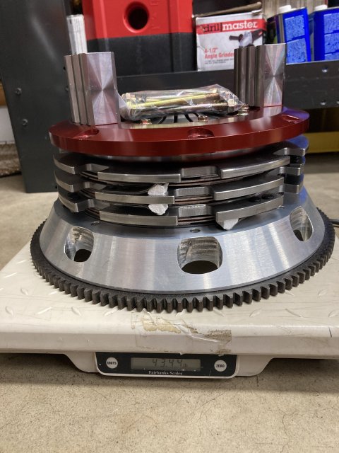

Finally weighed my Mantic triple, here’s its weight and the weights of a stock unit and a Mcleod RXT1200HD on a Ram Alum flywheel.
Here’s the Mantic and it’s flywheel
4633C719-A0B5-443A-A3F7-999E447BF1CF.jpeg DDC8ADB9-4B42-4974-BB5A-409D4D3DDD38.jpeg
Here’s weights on the stock unit and McLeod.
Stock clutch (38.44 lbs) and flywheel (23.50 lbs) = 61.94 lbs for the assembly
McLeod clutch assy (40.78 lbs) and Ram Flywheel (19.24 lbs) = 60.02 lbs for the assembly
Mantic clutch (31.82lbs) and Mantic Flywheel (11.62 lbs)= 43.44
So the Mantic assy is 18.5 lbs lighter then stock and 17.38 lbs lighter then the McLeod/Ram combo. Along with the Mantic clutch Assembly being about 4” in diameter smaller then where the weight is in the stock and McLeod setup and 18 lbs avg lighter then both should greater reduce MOI for quicker spool up and be easier on synchros in high rpm shifting by letting engine rpm drop off quicker off throttle. Unfortunately I won’t be changing my clutch out until my RXT1200HD gives up it’s ghost which may be a long while as it’s been doing fine so far.

~18lbs is a lot...
Maybe worth the effort...
