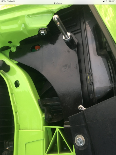

I’m buying a second hood for my my car and installing the Mopar pins. I’ve had my hood rise up while going 90 MPH on I80 across the Utah salt flats. Granted that day was windy with gusts up to 50 MPH but the hood still rises the faster you go. It’s kinda unnerving if you do open road racing or top speed runs. In my opinion the installation plates where the pins mount do need to be reinforced. I plan to do some fabrication and welding on that bracket to make the mount more solid. There was a member on the other forum who also did this and where I got my inspiration.

Picture of the modified bracket.

I see that you replaced that push pin with a real bolt. Good idea if the thing is actually going to be functional at high speed.

Marc, the picture I posted was from a thread on the other forum. I haven’t yet installed the pins, but I will modify and install just like the other member did to his sublime cat. I’d be down there right now to pick up your old hood but work gets in the way lol.

He did a nice job. The bolt replaced for the push pin in the front. It seems he added the dog ears on the side of the bracket as well with the new shiny non body painted bolt.
You can see where he sprayed that area with black paint. And added a screw for the safety wire instead of the plastic keeper plug. I like to tig weld, I may have a fun winter job it seems. I have faith in my system, but why not make it real strong!
As well he made the side dog ears and welded them on and bolted them to the side. Also replaced the plastic safety wire pin with a screw. Nice work!

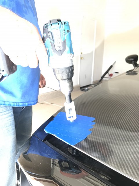

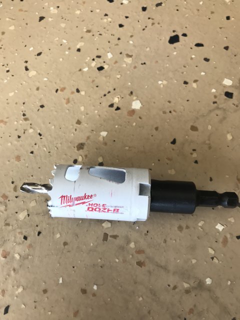

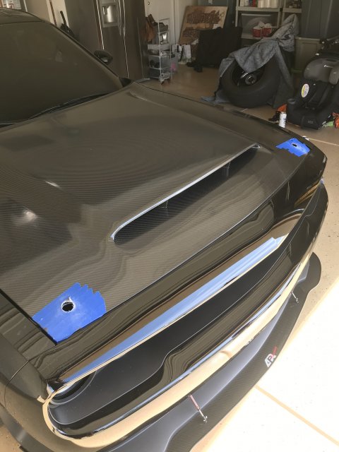

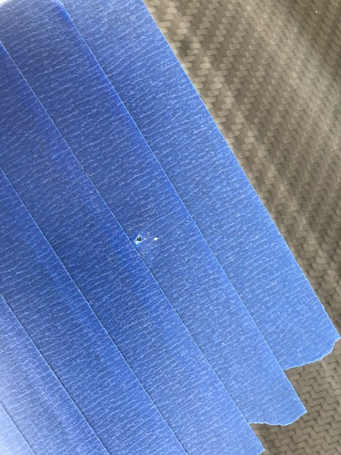

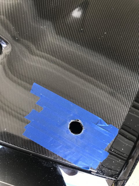

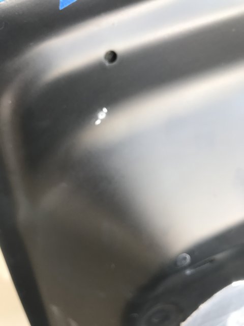

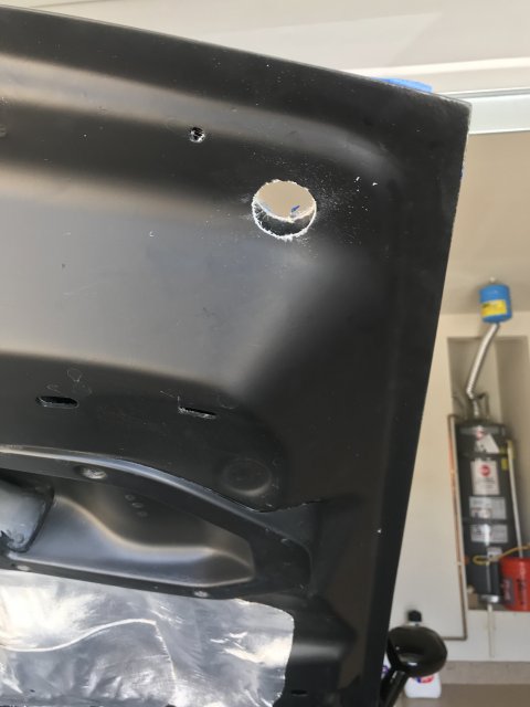

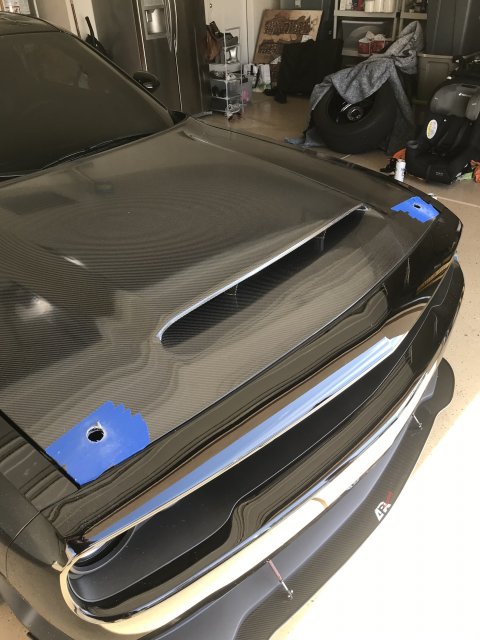

Well me and my pops did it our selves... Really was a easy job. Took about 30-45 minutes. Used some blue painters tape on top of the hood to prevent any cracking or chipping in the clear coat. Helps to prevent the spider Webb effect in the clear coat. 2B6ED622-1E62-403E-968F-671837BD54C3.jpeg 47E338DB-595C-4FDE-B483-C4962AD52C08.jpeg 42B01384-6D73-4152-8908-23CA419CFC53.jpeg E44A5151-D4FA-42B3-8AC9-AE31DE161AC3.jpeg 0DA60123-2F17-4CE4-8CDB-8EE40FFC8EC0.jpeg 1CCB7E14-372B-4B42-9268-2D1F4776C3CB.jpeg F4A7F75D-4AC6-4AB4-AF93-C5B74E6554AB.jpeg 9EC664A3-0FE3-462F-9956-7B76B71B0D6D.jpeg
