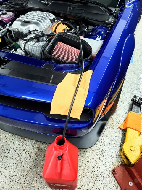

Decided to install some ID1300 injectors and try out some E85 fuel for the last track day of the season! Still working on the the tune, so this pass was without any additional timing added (yet). Unfortunately, after this first pass, the track prep went away and I blew the tires off on my last 2 runs. Will have to continue getting it dialed in next year I guess. Btw, this run was against my friend's stock C7 Z06 (on a drag radial) and I wish I had turned my camera to be looking out the passenger window... too much going on and I forgot!!
And a few shots of the preliminary work then hitting the track... 20221104_201721_2.jpg 20221025_220117_2.jpg 20221024_174633.jpg 94821b.jpg jeff vs shep launch c.jpg
