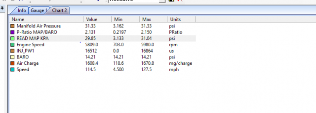

I just did a pull the car read 17psi. DA is +850
Speedy- I just looked at pRatio and it reads 2.190 for the pull I just did. I'll have to find a good PRatio calculator

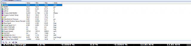

I'll have to add the Air Charge PID I thought I had it but I guess not.

What should air charge be? I just added the PID.

That all matches up.

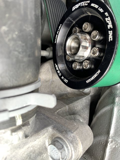

You double check the pulley size?

Totally off topic: Throttle position sensor percentage is showing 127%. How is that possible? Or is TP limited to less than the full possble so it registers as a TP vs allowed or OEM maximum?
Years ago when we were tuning the GTO TPS gave us some problems at first for some reason and would throw codes.
6,600
16,931
Normal
Yep checked it a few times before install.

Here is air charge. Is that low?

It's not low, but mine will see 2000+ in good air as a reference point. I'd say things are normal.

Sounds good da is around 800 so pretty good air. Thanks for the feed back.
